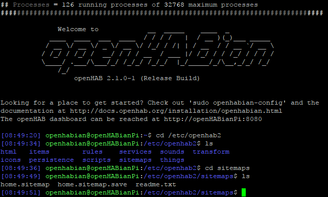

Hello ae_0017, yes, I have created my sitemap
but, afterlooking through the docs ifound that I have yet to define my sitemap. Unfortunately for me, the docs make everything seem harder than it is, so I still am unclear on how to define my sitemap! If you could give some more info on how to do that, that would be great!
