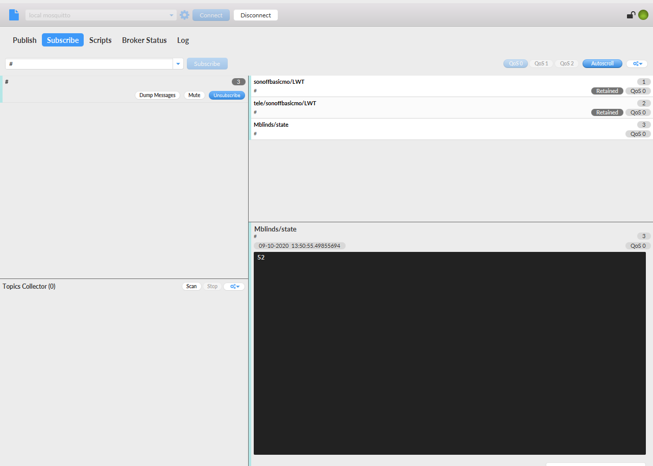

Then i checked it using mqtt broker , i could subscribe to the topic as shown , but i failed to publish to it .

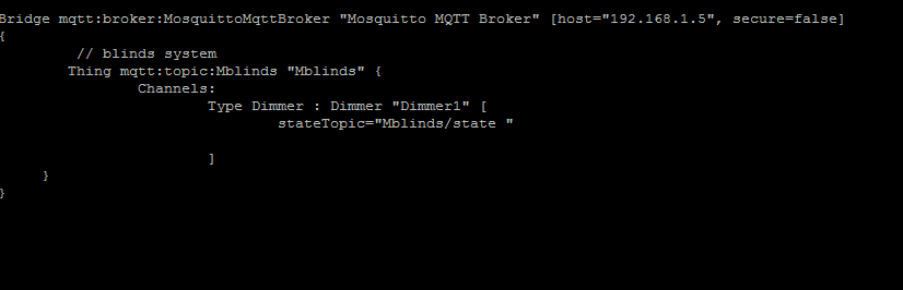

Things file :

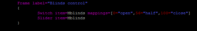

Sitemap file :
Any help please .. where is the problem ?
There is a space at the end of the value of the stateTopic.
could you more clarify your answer , please .

i had a mistake in defining my topic , it should be " Mblinds " not " Mblinds/state"
i have used my mqtt broker to publish to the new topic name and it seems to be working .
i also modified it in my things file , and tried to control using openhab , but the problem still exists .
should i insert a rules file ?
does the stateTopic should be replaced by commandTopic ?!
