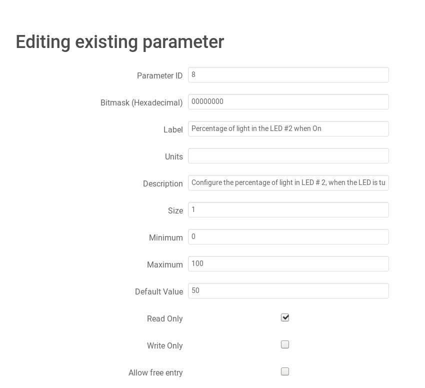

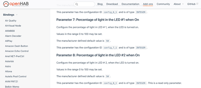

It is marked as read-only. Easily fixed, but the error checking also has the device flagged because of the INDICATOR class. @chris will need to take a look at it.

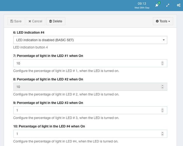

Thanks How can you see, that it is marked read-only? When I look at the device via the online device database, I cannot see a difference between #8 and e.g. #7, where #7 works as expected.
