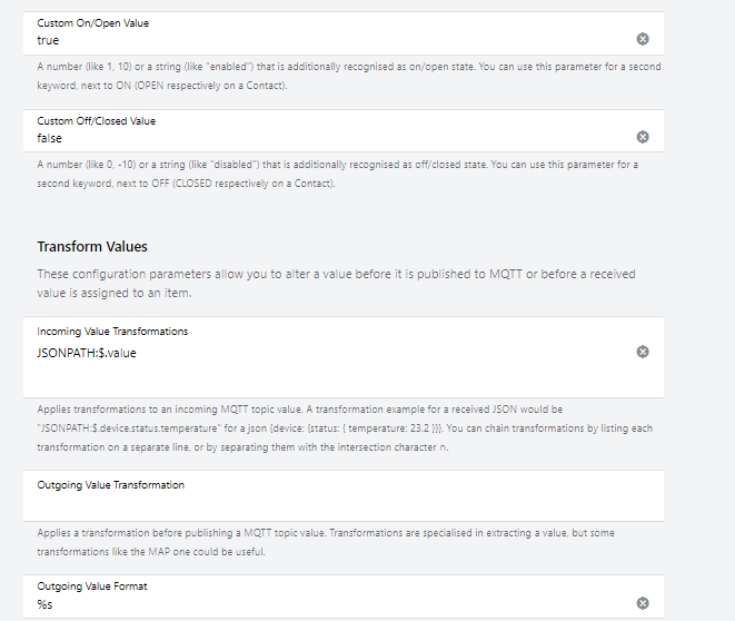

What is somewhat interesting in the linked example is that the transformation is in double quotes whereas mine are not. So, I understand the special character “-” is the cause. In my case I don’t understand how it got there. When I review the channel configuration there is no array character.
