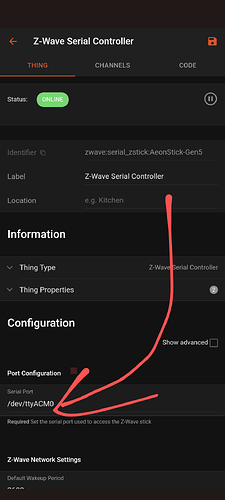

how do I configure the openhab binding for the Z-Wave.Me RaZberry 7 Pro?
Well you need to find out which serial port the Razberry us using, and that also depends on the operating system which runs openHAB. You simply need to configure this in the Z-Wave Controller thing and that’s it. I don’t have a Razberry shield, but there’s where you need to configure the correct port
