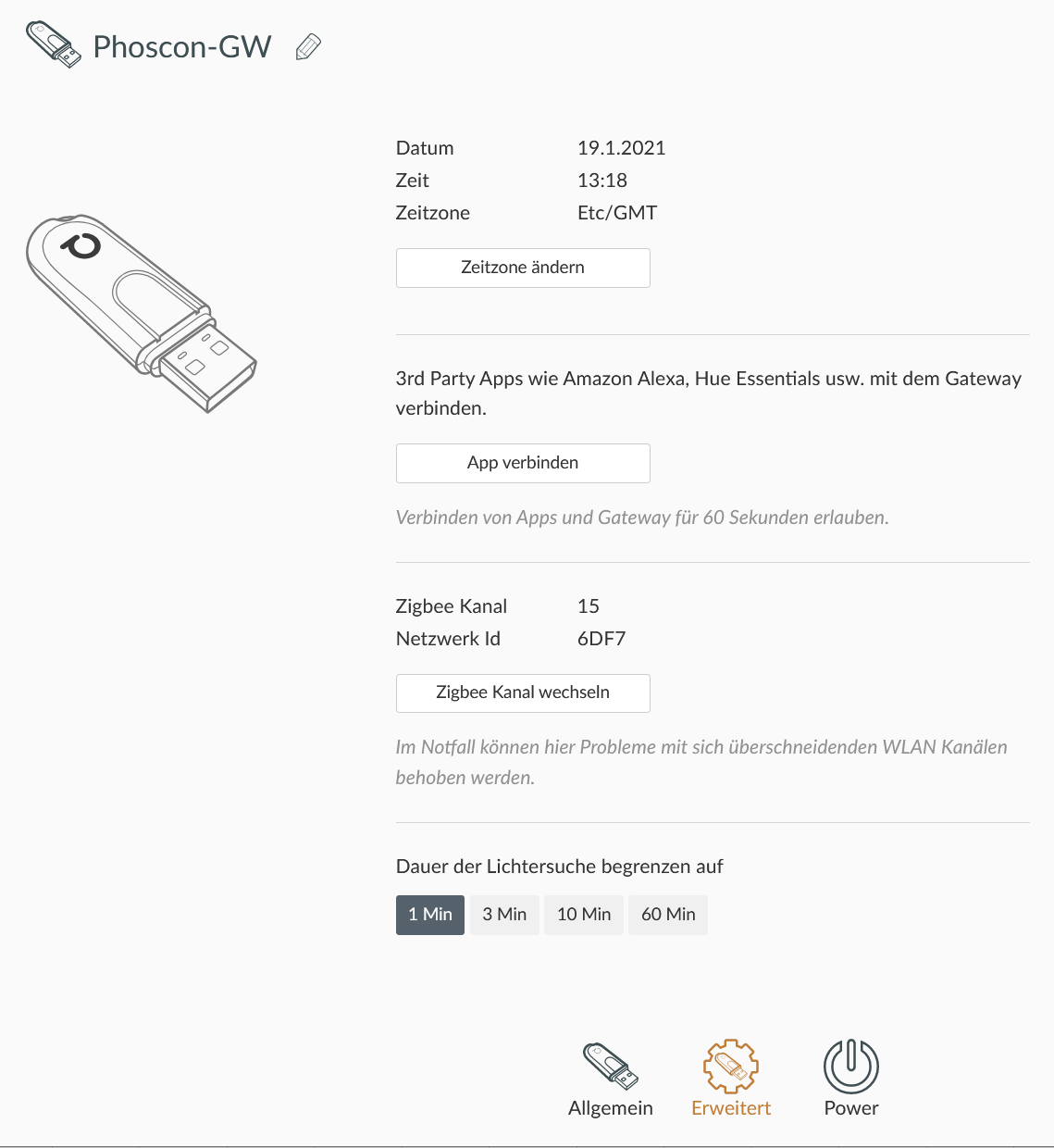

Solved.

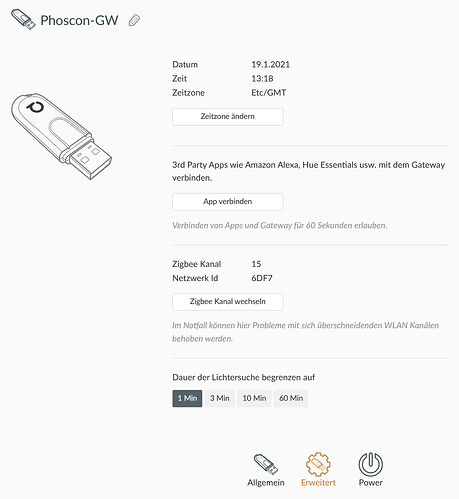

Getting Started - deCONZ REST-API. Here the screenshots for the German Interface

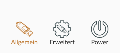

Click pancake menu top left and select Einstellungen-Gateway
Click “Erweitert” at the bottom
Click App verbinden and switch to openhab to complet process
openhab will now show an api-key in the deconz binding.
