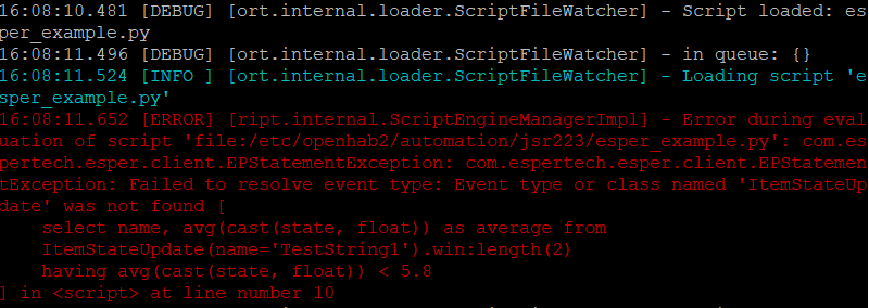

I tried installing jython like it’s described here but the example scripts are not working:
Do you have any idea what’s the problem?

I upgarded to 2.4.0~M5-1 the hello_world.py does work now but the esper_example.py still throws the same error as shown above :frowning:

Now I’m getting this error:
:persevere:
It looks like I screwed up the first import in esper_example.py when I moved it to the community package. This was from openhab import esper before I touched it. Change…
from community import esper
to…
from core import esper
Let’s see if that works any better for you.
Now I’m getting the error from my first post again (that the eventtype or class β€œItemStateUpdate” was not found) :see_no_evil:
