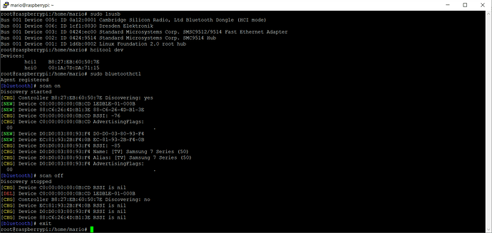

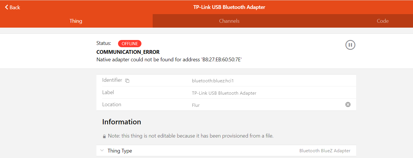

I’ve a TP-Link UB400 USB Nano Bluetooth Dongle connected. Unfortunately, I cant get it up and running. It always states:
I’ve installed the Bluetooth binding and installed a BlueZ Adapter Bridge Thing using the following text file:
Bridge bluetooth:bluez:hci1 "TP-Link USB Bluetooth Adapter" @ "Flur" [ address="B8:27:EB:60:50:7E", backgroundDiscovery=false ]

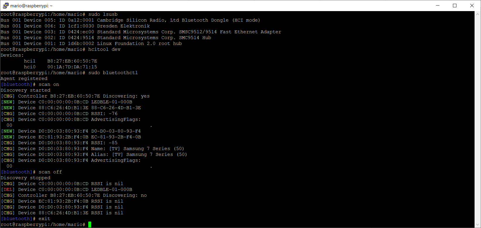

However, it looks like the adapter is recognized by my RPI and it does something.
It shows up after executing command lsusb (Camebridge Silicon Radio) and as well as for hcitool dev (hci1). If I search for BLE devices, it returns with some existing…
I think the issue might be related in the mapping of the device to the Docker container? In my YAML I use the following command:
    devices:
      - /dev/ttyACM0:/dev/ttyACM0
      - /dev/ttyAMA0:/dev/ttyAMA0
While ttyACM0 is my “Dresden Elektronik” (conBee2) USB stick - which is working fine, the ttyAMA0 is the USB Bluetooth adapter. However, with this setup I’m getting the above error message stating the there is a Communication Error.
