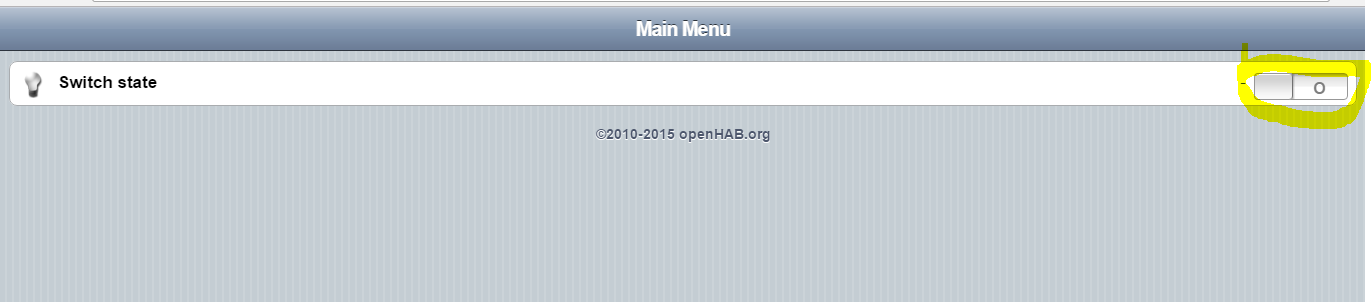

4- http://localhost:8080/openhab.app?sitemap=demo
5- html page showing but functio light on/off functionalities not work
suggested step not working. can you tell me how it does work. can you suggest another method
