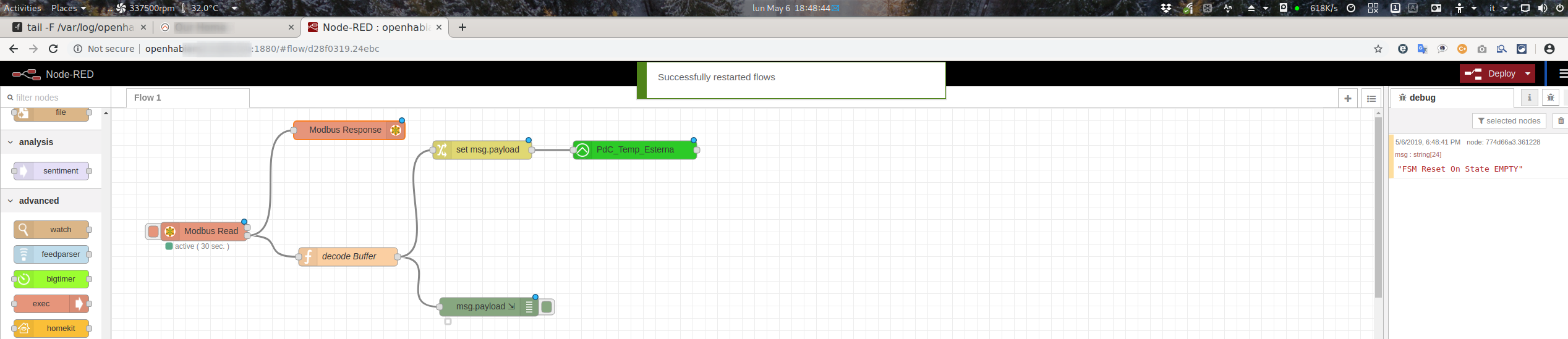

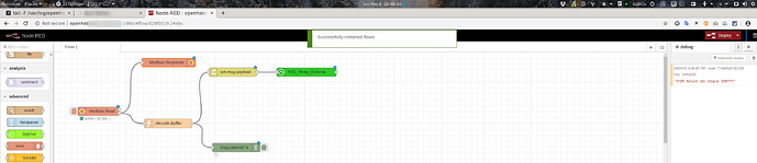

I’m not sure if it’s allowed to post external links here, but I’ve written a short tutorial on my blog on how to connect an iDM Terra ML Complete HGL heat pump via node-red to OpenHAB.
