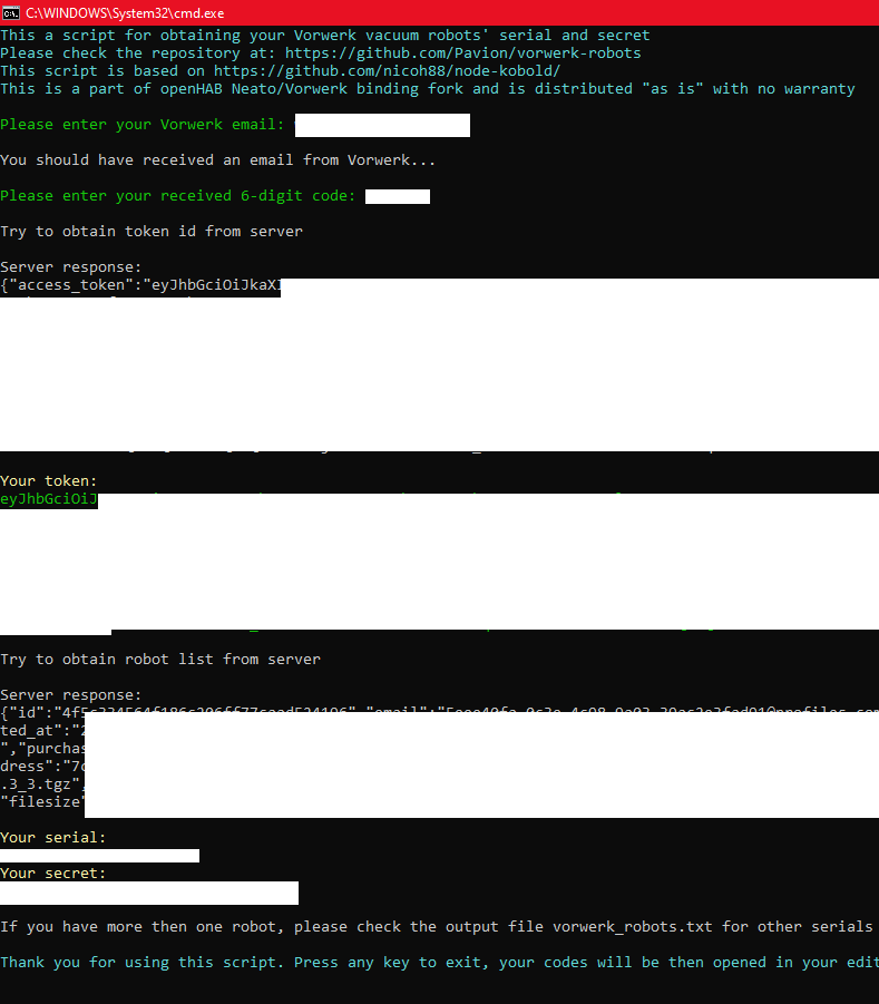

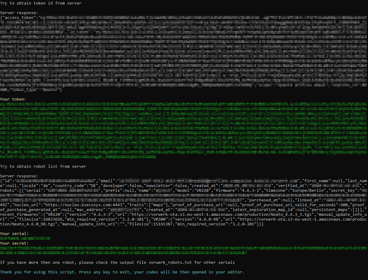

The most difficult part was the Neato Vacuum: Secret, Serial and oAuth.
I managed to do this with a Windows Bat, but I can’t find the description or where I got it.
I still have a copy on my computer.
here we go: GitHub - Pavion/vorwerk-robots: Scripts for obtaining your Vorwerk robot details required for some home automation systems as openHAB

Just came across trying this out (had to learn that jq needs to be installed if the script is run on Linux, see here). Also learned that the eMail that is sent by Vorwerk contains a link that can only be opened on a device with the Kobold app installed.

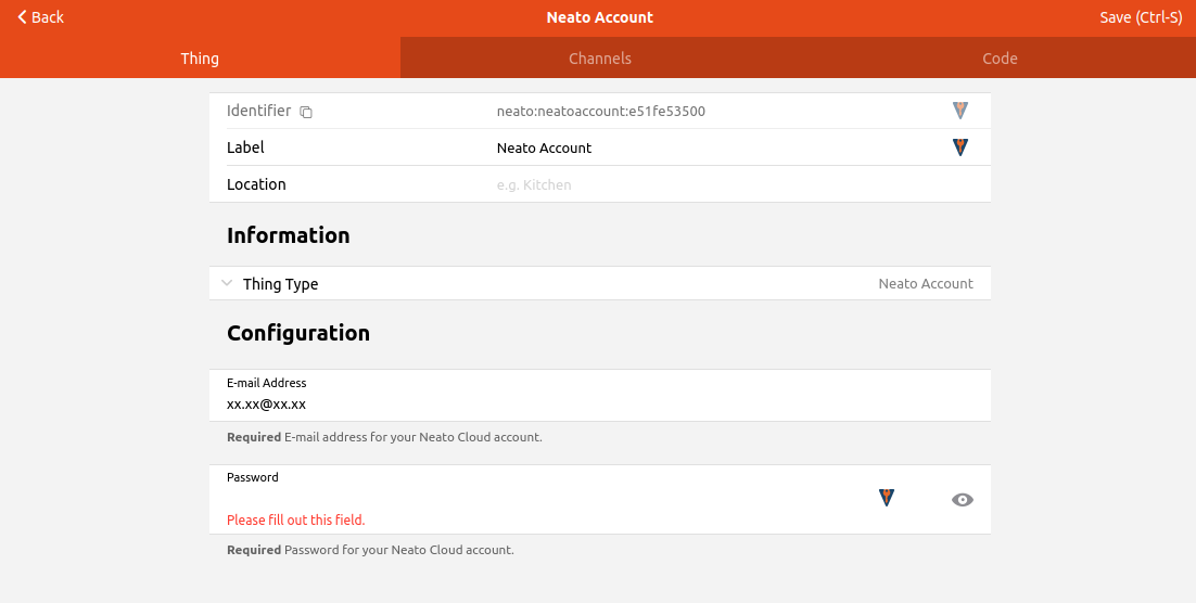

@kl8ter, in the Neato binding, what’s the password that needs to be entered here? I now tried out my Kobold password, the OTP (6 digits) as well as the secret…
… but all three result in COMMUNICATION_ERROR** Could not find robot_serial for specified vendor_name". Am I missing something?
Btw: A rather odd observation: The robot serial number extracted by the script adds one extra character (in my case an 8) compared to what’s shown in the Vorwerk App or on the robot itself.

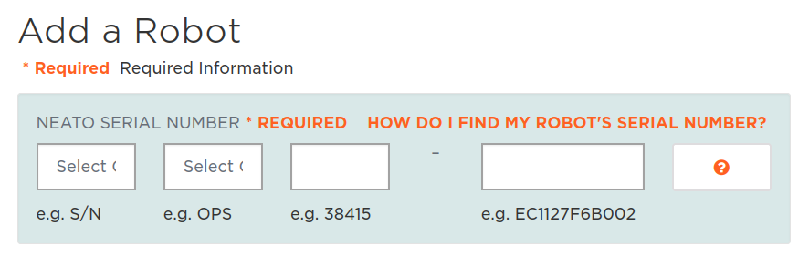

Is there a need to manually add your Vorwerk to the Neato account?
If yes, with which numbers? The Serial which the curl script extracts has a completely different format.
As I am also finding out right now is that I can no longer access my neato accout either.
But I mean the information can be found on the vacuum cleaner. On em nameplate.
Yep, true. I found those as well. However, format is completely different compared to what Neato expects in the online.
From what I can see, it might not be possible anymore to include Vorwerk robots into the Neato account via this “undocumented workaround”?

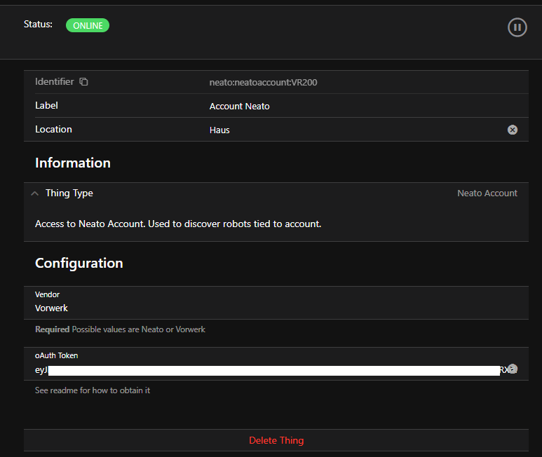

As I understand it now, you don’t need the neato account anymore, you just need to have an account with Vorwerk where your hoover is integrated.
Then run the *.bat file and enter your email address from the Vorwerk account. You will then receive an email with a code and enter it there: Then you will have everything you need:
Here is the bat:
Copy the text put it in a Editor and save it to vorwerk.bat
then start it.

As mentioned in my response above, I did obtain the token, secret and serial via the script. But unfortunately I can’t get the binding to find the robot.

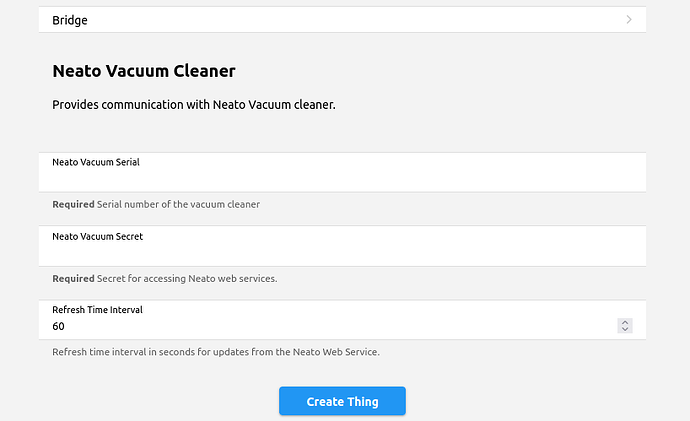

Configuring the “Robot-Thing” is pretty straight forward: Both Serial and Secret are retrieved via the script. The “Neato-Account-Thing”, however, requires a password, which I can neither set nor obtain.
If I understood Vorwerk’s account policies correctly, there is no password (anymore). If I want to login (e.g. in the App), you only get a OTP via eMail, since the account does not have a fixed password anymore. And using the OTP as the Password in the “Neato-Account-Thing” also does not work.
Can you tell where you set or maintain the password which you entered into the “Neato-Account-Thing”?

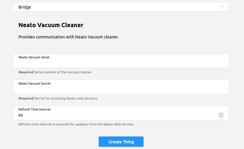

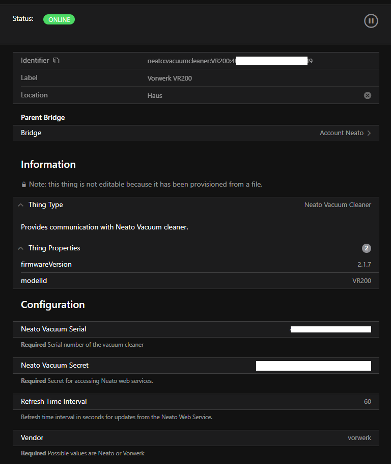

As yesterday reported, my fork still works for Vorwerk (official Neato Binding never supported it). You only need your serial and secret obtained with my script above. You don’t need to create a bridge, just use both values with proper vendor vorwerk to create your Vacuum Thing.
Pav
Hehe, no offense, @Pavion. :wink:
Quick question: Where is the vendor vorwerk specified? I do see possibilities for the serial and the secret, but not the vendor.
Or is this specified in the code of the thing-configuration?
I assume you have the native Neato binding, you must use my fork for the vendor option.
