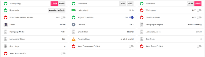

You maybe right. Here is a screenshot of what i am doing using your binding:
OH and your binding provide Alexa integration to me and my wife. That’s really nice.
