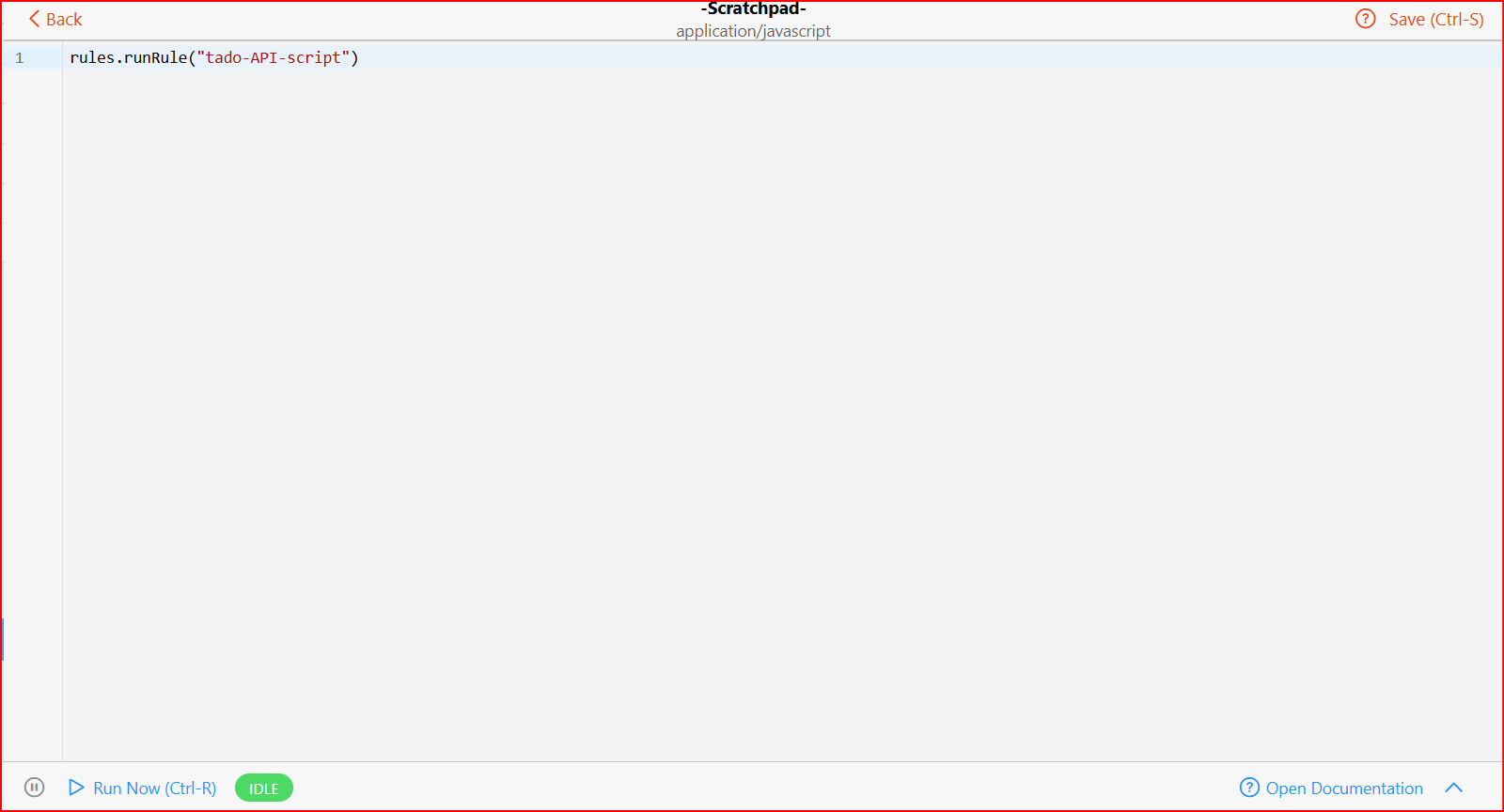

In any case, something unexpected happened. This is the “Script” (as a first step, I’m running the “Script” from another “Script”, and plan to migrate to a “Rule” in a next step) I ran:
rules.runRule("tado-API-script")
This is the “script” (i.e. rule) with Script ID tado-API-script:
console.log("hallo");
This is the output:
19:58:58.317 [INFO ] [tion.jsscripting.rule.tado-API-script] - hallo
19:58:58.318 [INFO ] [tion.jsscripting.rule.tado-API-script] - hallo
19:58:58.319 [INFO ] [tion.jsscripting.rule.tado-API-script] - hallo
19:58:58.320 [INFO ] [tion.jsscripting.rule.tado-API-script] - hallo
Why does it run 4 times?

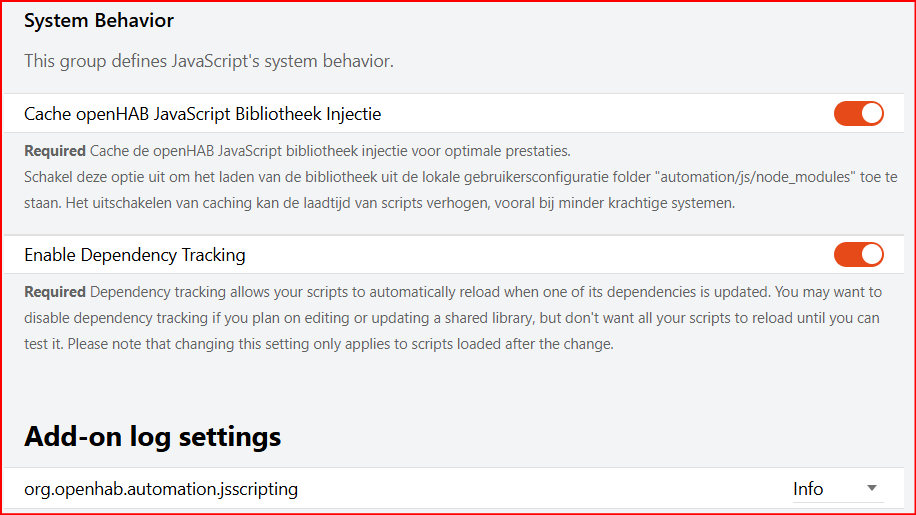

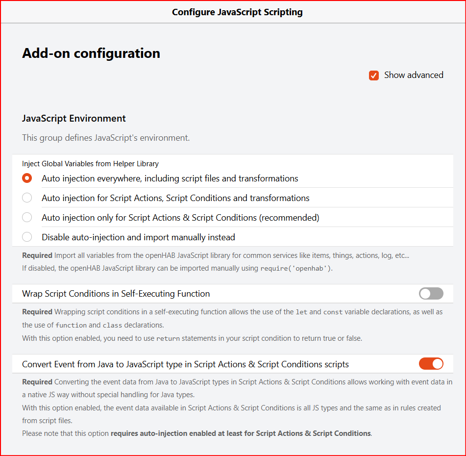

Have you changed any of the jsscripting add-on settings away from their defaults?
Not that I’m aware of:

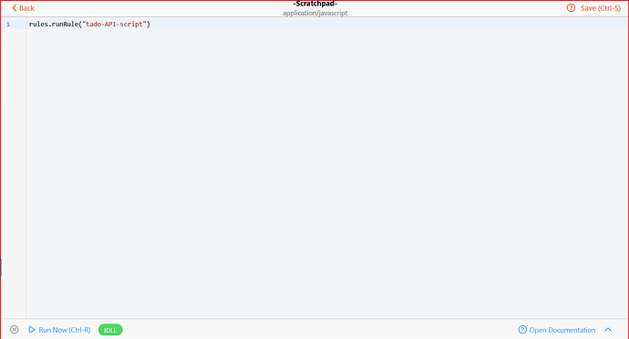

That can prove informative, in this case it tells us whether your manually run script is running four times, or whether it’s just the called script that is running four times.
Apparently neither:
16:17:32.343 [INFO ] [openhab.event.RuleStatusInfoEvent    ] - scratchpad updated: RUNNING
16:17:32.346 [INFO ] [openhab.event.RuleStatusInfoEvent    ] - tado-API-script updated: RUNNING
16:17:32.347 [INFO ] [tion.jsscripting.rule.tado-API-script] - hallo
16:17:32.350 [INFO ] [tion.jsscripting.rule.tado-API-script] - hallo
16:17:32.352 [INFO ] [tion.jsscripting.rule.tado-API-script] - hallo
16:17:32.355 [INFO ] [tion.jsscripting.rule.tado-API-script] - hallo
16:17:32.358 [INFO ] [openhab.event.RuleStatusInfoEvent    ] - tado-API-script updated: IDLE
16:17:32.361 [INFO ] [openhab.event.RuleStatusInfoEvent    ] - scratchpad updated: IDLE
