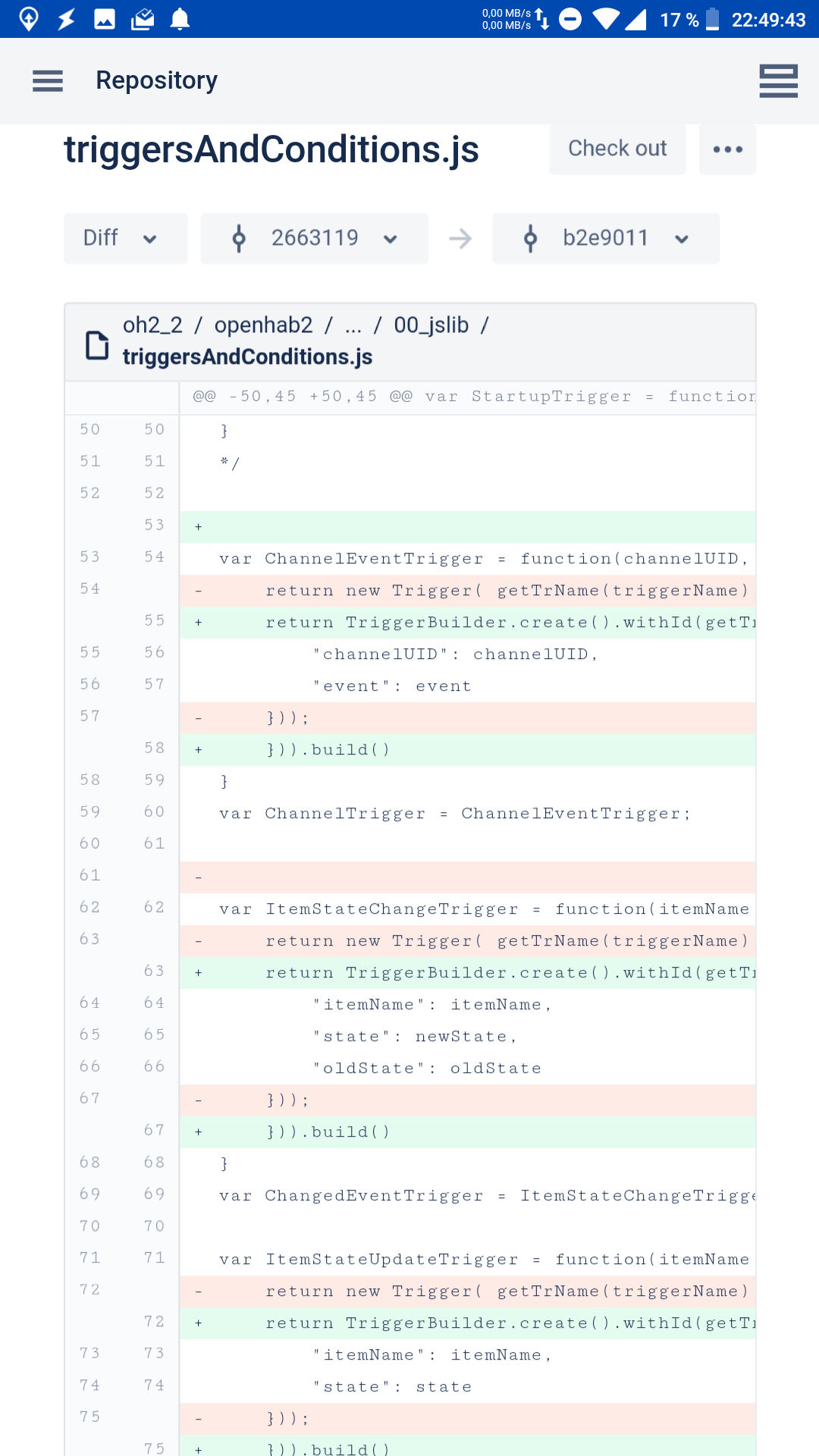

@illnesse I will give Javascript a try. I am using openhab 2.3.0 stable. When I copy th openhab2_pub_001/00_jslib files and try a simple rule, I see this error: Error during evaluation of script 'file:/etc/openhab2/automation/jsr223/carl.js': ReferenceError: "TriggerBuilder" is not defined in /etc/openhab2/automation/jsr223/00_jslib/triggersAndConditions.js at line number 63
My guess is that you are running another version of openhab and that the api has changed.

Thanks, I will take a look at it tomorrow. If by any chance you have a diff command for this (I have cloned the repo and I am using IntellIJ) that would be helpful.
