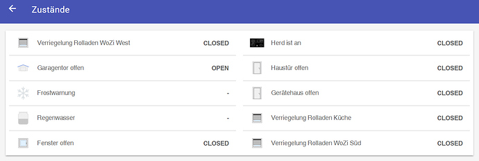

Never noticed before, but it seems, that the state of a contact item like this:
Contact KNXStatusmeldungen_Haustuer "Haustür offen [%s]" <door> (gStatus) {channel="knx:device:bridge:statusmeldung:haustuer"}
is not rendered in Paper UI. I’ve found two (quite old) threads regarding this issue, e.g. this one:
I have to admit that I’m using Paper UI just for setup (as it is intended for ) and not for daily operation.
But I you have a look at the control tabs in the Paper UI it’s at least confusing that the states of contact items are not shown:

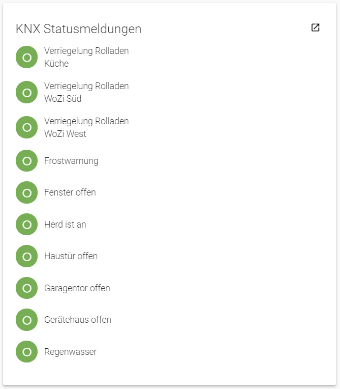

In the BasicUI it’s there, as expeted
