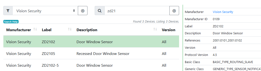

Hi I have updated the DB entry for ZD102, and the review has been accepted, what is the next step to import the updated DB
grafik
So it should be supported by the latest snapshot available from openHAB-ZWave - Jenkins
