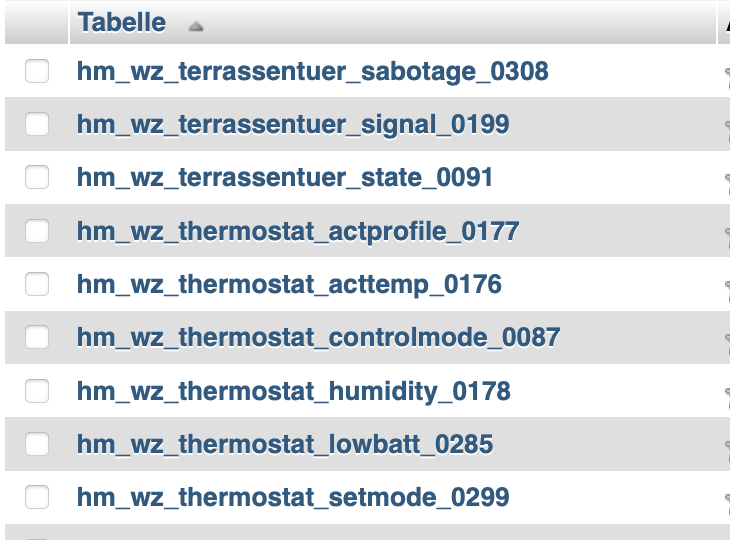

This is how the item tables look:

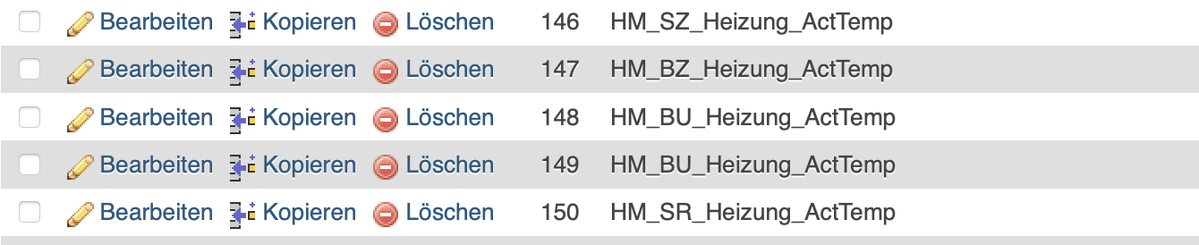

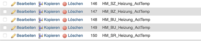

This is a part of the items table with the item-ids:
