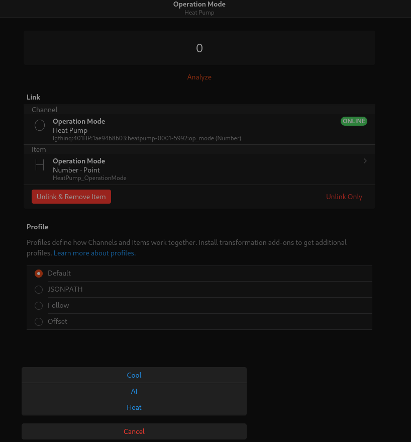

Problems saw so far:
Operation mode cannot by changed and also contains Cool, Fan, Dry instead of Cool, Heat, Ai

This should be a persistence cache. I simulated the same capability file you provided and the channel Operation Model options are “Cool, Heat and AI”:
I suggest yout to remove the thing and try to add it again and, in the last case, restart OH.
If you still can’t change the Operation Modes, provide me the logs at the moment you tried to change it.

Indeed a restart fix the Operations Modes
But still cannot change mode
heatpump.txt (2.9 KB)
Very strange… error 9006 means Access Denied from LG API. Can you change your Heat Pump’s mode from LG App ? If so, if you change the mode from LG App, the Operation Mode Channel in the Binding is updated as well ?
Yes from mobile App everything is working.
On Off also works from openhab.
When I change mode from app I see logs changing in openhab but the mapping seems to be wrong
As I see the correct mapping is AI=3, Heat=4, Cool=0 from airState.opMode
But now it’s AI=4, Heat=5, Cool=1 from support.airState.opMode I suppose

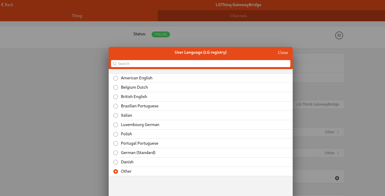

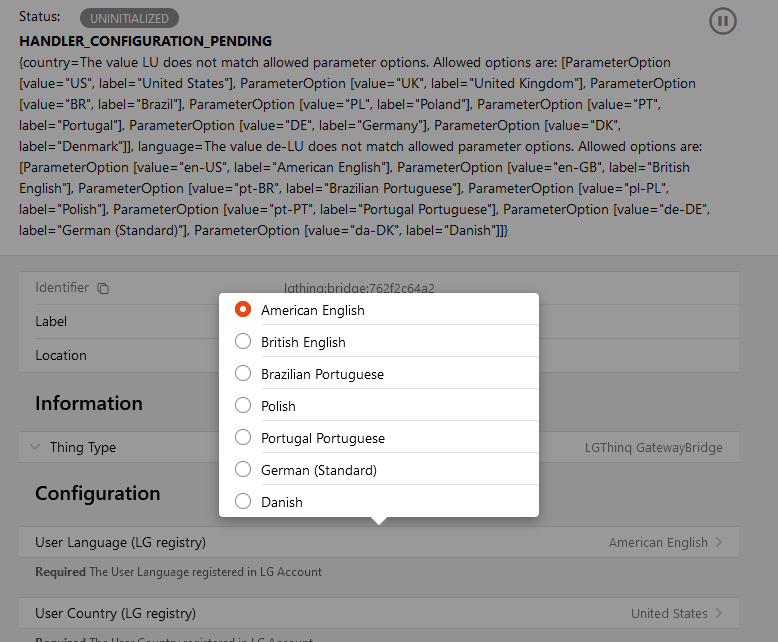

Hello @nemer
On March you added the country code de-LU for me and it works like a charm. Now i have done an update and the country code seems to have been removed. I get the error:
{country=The value LU does not match allowed parameter options. Allowed options are: [ParameterOption [value=“US”, label=“United States”], ParameterOption [value=“UK”, label=“United Kingdom”], ParameterOption [value=“BR”, label=“Brazil”], ParameterOption [value=“PL”, label=“Poland”], ParameterOption [value=“PT”, label=“Portugal”], ParameterOption [value=“DE”, label=“Germany”], ParameterOption [value=“DK”, label=“Denmark”]], language=The value de-LU does not match allowed parameter options. Allowed options are: [ParameterOption [value=“en-US”, label=“American English”], ParameterOption [value=“en-GB”, label=“British English”], ParameterOption [value=“pt-BR”, label=“Brazilian Portuguese”], ParameterOption [value=“pl-PL”, label=“Polish”], ParameterOption [value=“pt-PT”, label=“Portugal Portuguese”], ParameterOption [value=“de-DE”, label=“German (Standard)”], ParameterOption [value=“da-DK”, label=“Danish”]]}
Could you add it for me again? or can i add it myself?
Thank you
See this post, please:
Thank you @nemer , this is a good idea.
I currently have no “other” as I installed the binding from the default web console.
So I would like to try your new version. I have downloaded this:
I have copied it into my add-on folder, but as I never have done this(update), what should I do next? Uninstall official binding?
Thank you again for this great binding.
Or is it planned that the public version of the binding gets updated with the “other” feature?
It most likely you are using a very old version.
This is the last version installed locally:
I’m uploading the last version again, just to confirm I haven’t been made some mistake…
Please, try to download and install the binding again. If it still doesn’t work, probably is some problem in your installations process. In this case, I suggest you to check the logs for the binding deploy process.
