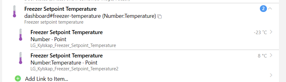

No errors now when creating a new item, so that’s good. But there’s still no lookup of the value, so whatever’s being displayed is wrong unless I manually add the associated state metadata.
This is a screenshot at my two items. The lower one (ending in 2) is created simply through the UI. The first one I’ve added metadata (“State description”) for to map value to actual temperature, as in the LG JSON file.
This is how my mapping looks like (8 corresponds to -23):
Can you share with me the thinq-XXX-datatrace.json and thinq-XXXX-cap.json files ?
