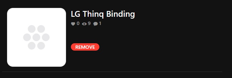

Contribution - LG ThinQ Binding
Hi there, thanks, I’m aware of that → not possible for this particular binding (e.g. the “astro” binding has that blue gear icon you mentioned).
Why not ?
Marketplace Bindings are shown in the UI and have that icon.
Can’t tell :wink: ..
Thats strange.
Tried it yesterday with a different Marketplace Binding and saw the little gear icon. Today, it is gone…
Third Party Marketplace Bindings like Smathome/J Tuya Binding still have this icon…
We will have to check…..
@florian-h05 Do you have an idea what’s wrong here ???
The UI decides in openhab-webui/bundles/org.openhab.ui/web/src/pages/addons/addon-details.vue at 8e357f40df7200cf7b87e3fe79a1d5ef1b912938 · openhab/openhab-webui · GitHub whether to show the config gear based on the addon info that is loaded in openhab-webui/bundles/org.openhab.ui/web/src/pages/addons/addon-details.vue at 8e357f40df7200cf7b87e3fe79a1d5ef1b912938 · openhab/openhab-webui · GitHub.
Can you please check the browser network tab (browser dev tools) for a request to
/rest/addons/someAddonId?serviceId=someOptionalServiceId
and share the response here?
And probably ping me in the answer so I notice it.
@florian-h05
A query of /rest/addons to get all bindings does not list any Marketplace Bindings.
Even trying
/rest/addons/marketplace%3A158233
for the LGThinQ Binding lead to a 404…
Is that what the UI does when opening the add-on detail page for this binding?

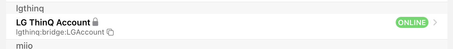

i am getting now an error in the logs:
2024-12-16 19:17:46.736 [INFO ] [.thing.internal.GenericThingProvider] - No ThingHandlerFactory found for thing lgthinq:401:LGAccount:HP (thing-type is lgthinq:401). Deferring initialization.
in the gui, I only see one lg thing:
