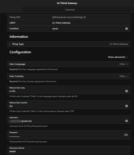

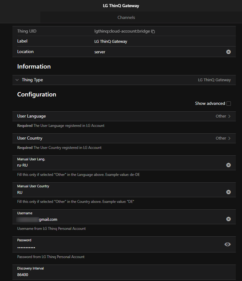

Binding doesn’t work, reports an error
Status: OFFLINE
**COMMUNICATION_ERROR**
Communication Error with LG API
My Config
Tell me what I’m doing wrong, please (((( :sad_but_relieved_face:

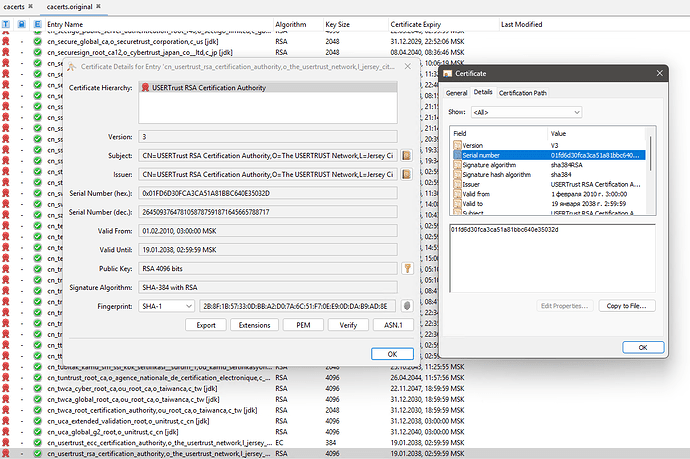

LG Servers test (for RU)
=== LG Servers Connection Test ===
Java version: 21.0.9
Java home: r:\servers\openhab\jdk\openjdk21u-jdk_x64_windows_hotspot_21.0.9_10
1. Testing with STRICT SSL verification (like OpenHAB):
? https://ruic.lgthinq.com:46030/api                           | Code: 200 | Time: 1844ms
? https://ruic-service.lgthinq.com:46030/v1                    | Error: IOException: Server returned HTTP response code: 400 for URL: https://ruic-service.lgthinq.com:46030/v1
? https://ru.m.lgaccount.com                                   | Code: 200 | Time: 598ms
? https://ru.m.lgaccount.com/spx                               | Code: 200 | Time: 111ms
? https://ru.emp.lgsmartplatform.com                           | Error: FileNotFoundException: https://ru.emp.lgsmartplatform.com
? https://ru.lgeapi.com                                        | Error: FileNotFoundException: https://ru.lgeapi.com
? https://ru.emp.lgsmartplatform.com/                          | Error: FileNotFoundException: https://ru.emp.lgsmartplatform.com/
? https://ru.lgemembers.com/lgacc/service/v1/                  | Error: FileNotFoundException: https://ru.lgemembers.com/lgacc/service/v1/
? https://ru.rac.lgeapi.com                                    | Error: SSL Error: CertificateExpiredException: NotAfter: Wed Jul 17 02:59:59 MSK 2024
  --> Possible certificate store issue!

Sorry for the late reply. I’m currently on vacation. Based on the logs you shared, this does not look like an issue in the OpenHAB add-on itself. It looks like a TLS/SSL certificate problem on the LG RU endpoints.
The key line is this one:
SSL Error: CertificateExpiredException (NotAfter: Wed Jul 17 02:59:59 MSK 2024)
If an endpoint (or the certificate chain it presents) is expired or invalid, Java will fail the TLS handshake by design. OpenHAB runs on the JVM, and the JVM is quite strict about certificate validation for security reasons. Because of that, I don’t recommend any workaround that disables SSL verification or “trusts” an expired certificate, that would reduce security and could expose your account/session to interception.
When I’m back and have more time, I’ll dig deeper and propose the best next steps. In the meantime, if you want to help confirm the root cause, you can run (or share) a quick certificate check from the affected network, for example:
curl -vI https://ru.rac.lgeapi.com/
or openssl s_client -servername ru.rac.lgeapi.com -connect ru.rac.lgeapi.com:443
Thanks again for the detailed report. it’s very helpful, and I’ll update you as soon as I have a safe troubleshooting path.
Hi! Thanks for your reply.
I compiled the extension and checked its operation in debug mode.
The problem occurs when accessing this site: https://ru.emp.lgsmartplatform.com/emp/v2.0/account/session/user@domain.com.
I weakened the SSL using the httpClient in RestUtils.java’s postCall method and was able to obtain a auth token when calling methid loginUser (which is where the connection failure occurred). Then I removed the debug jar and installed your original binding. Everything works.
I wanted to find the httpClient settings, but I don’t know how to clear auth token. The loginUser method is no longer called because the token has already been received. How to force reset token?

Your results strongly suggest a truststore / CA bundle mismatch between the JVM used by OpenHAB and the JVM used in your standalone Java test, but your analysis will confirm me better about that.
As I understand it, the server sends the root certificate (USERTrust RSA Certification Authority, third below in the command output) in the chain.
This is a self-signed certificate, according to SSL. I assume this is a server configuration issue, if I’m correct. The server might not be sending the full certificate chain. The USERTrust root certificate shouldn’t be in the chain sent by the server - only intermediate certificates should be sent.

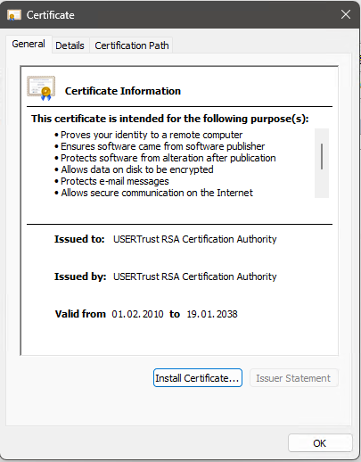

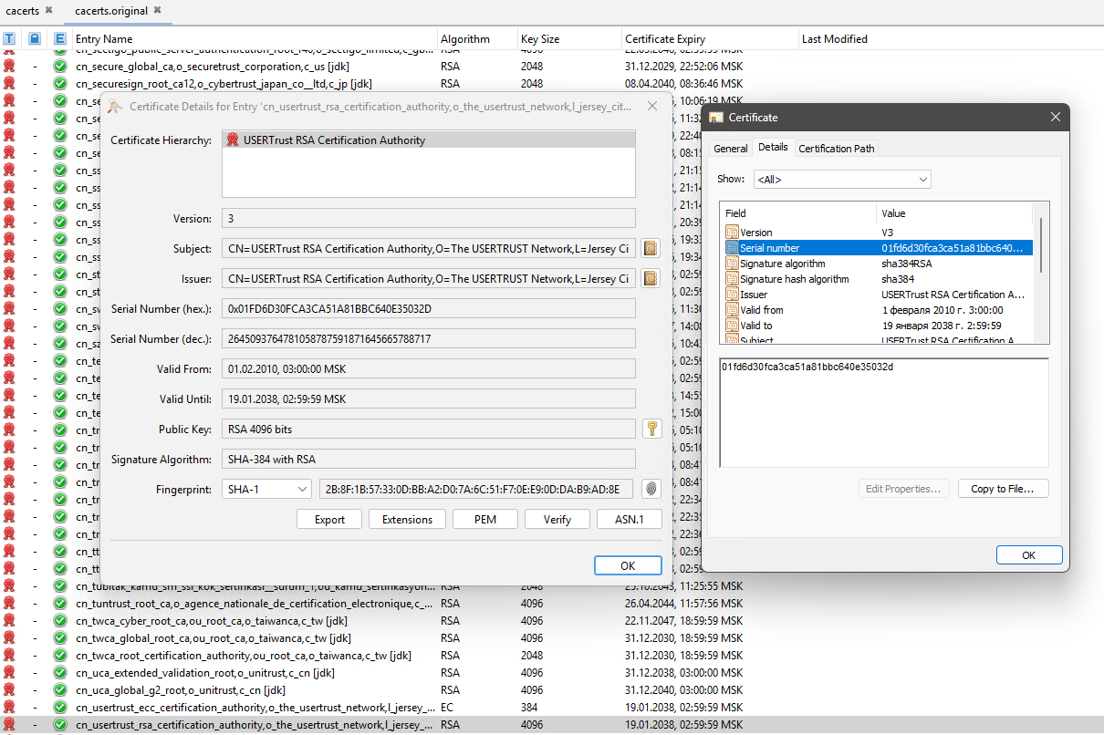

Cerificate: USERTrust RSA Certification Authority
It exists and is available in cacert
