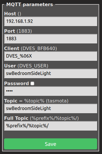

b. Configure MQTT
In a browser:
  1. Navigate to your Tasmota device’s MQTT configuration page: http://<tasmota-ip-address>/mq
  2. In Host, enter the IP address of the device which is running Mosquitto.
  3. In User, enter a unique name for this device.
  4. In Topic, enter the same name as you did for User.
  5. Leaving everything else as it is.
  6. Click Save. The device will re-start, and kick you back to the Main Menu.

These examples are great, and if you haven’t already I would strongly urge you to post them as separate topics within this forum in the Solutions category! Three things I would recommend, after my experience as a beginner:
  • Add the device name in the thread title, as well as the communication method (MQTT). If it uses Tasmota, include that too!
  • Provide complete examples which include the MQTT bridge - many examples omit the bridge itself, so when you’re first starting out it can be quite confusing!
  • It looks like your Tasmota Full Topic is %topic%/%prefix%/, rather than the currently default %prefix%/%topic%/ - might be worth mentioning that too, and maybe showing the Tasmota MQTT parameters. There’s a mixture on this forum, and it’s rarely mentioned, which caused me some headaches when I started out!
