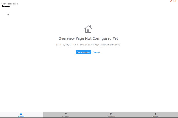

Have tried to create a model card but cannot find anywhere so far that has an action item to set which is just me not getting the new UI/ model concept of OH3.

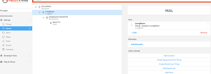

Do i create it in settings under the model

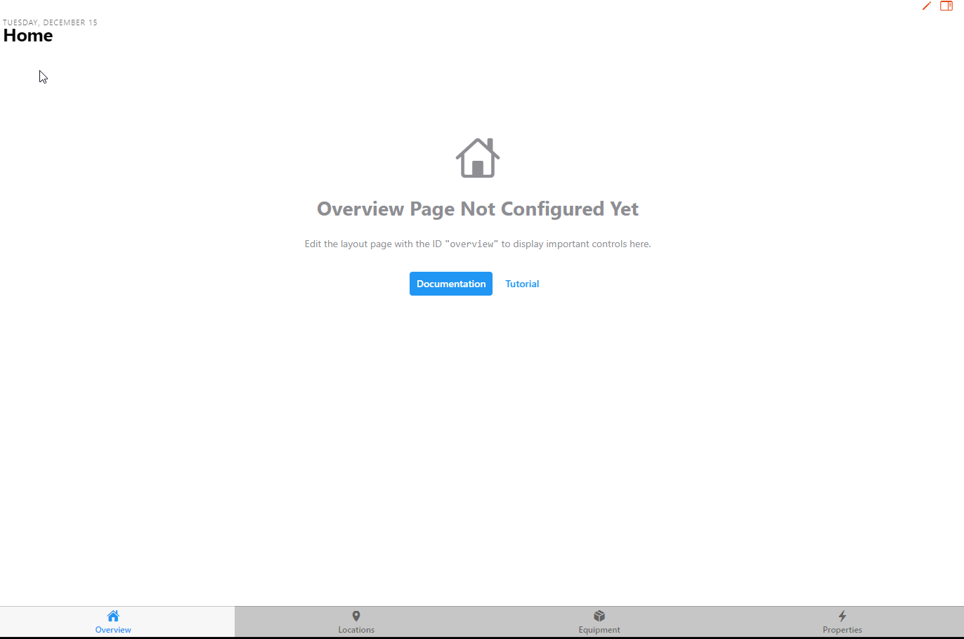

or is it from the home page?
Go to settings -> Pages. Edit the Overview Page and add the card.
As this was my first item there was one more step which was to add mortar and then it all made sense.
