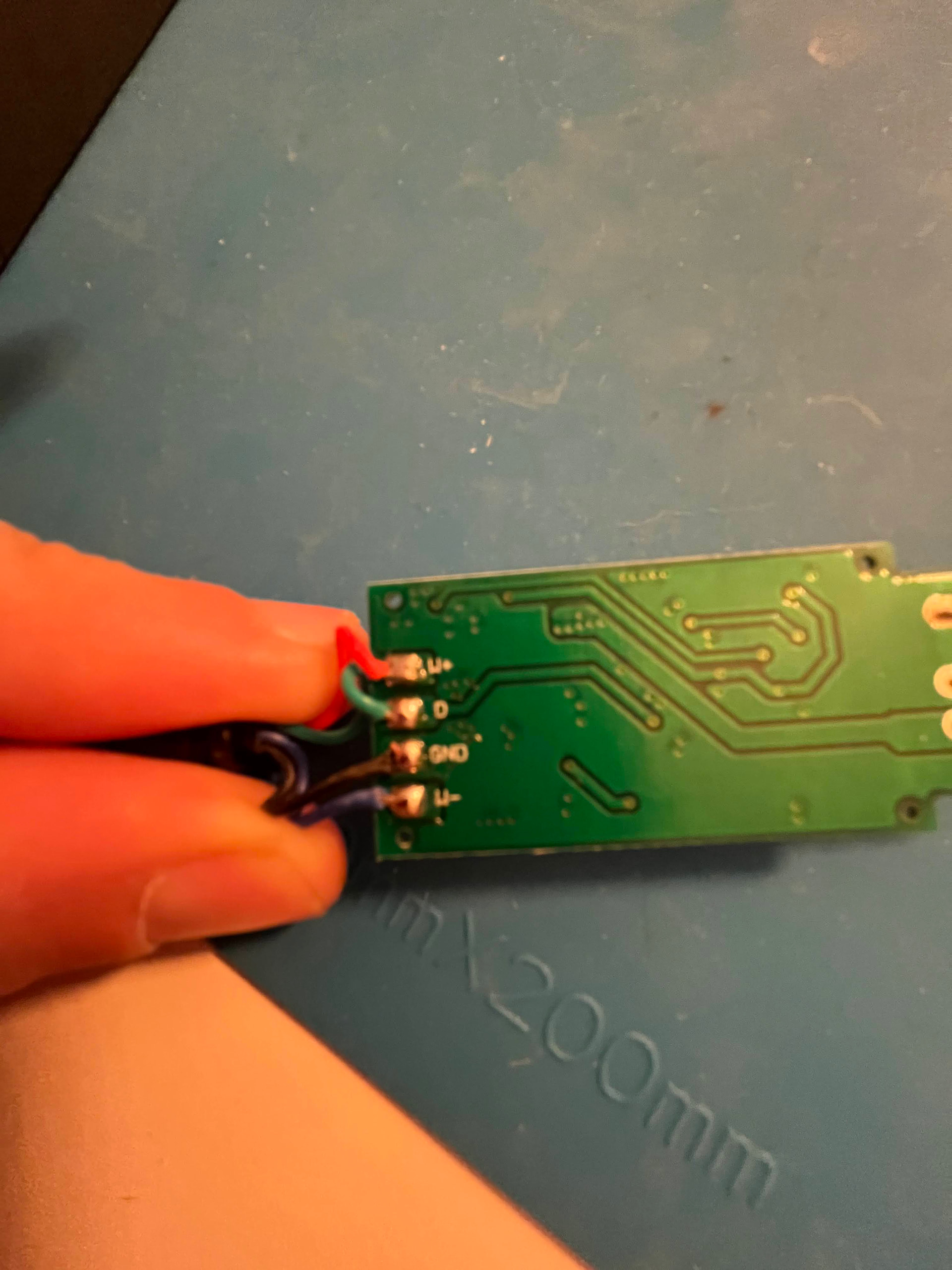

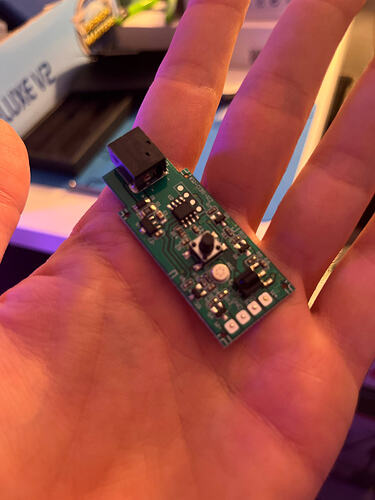

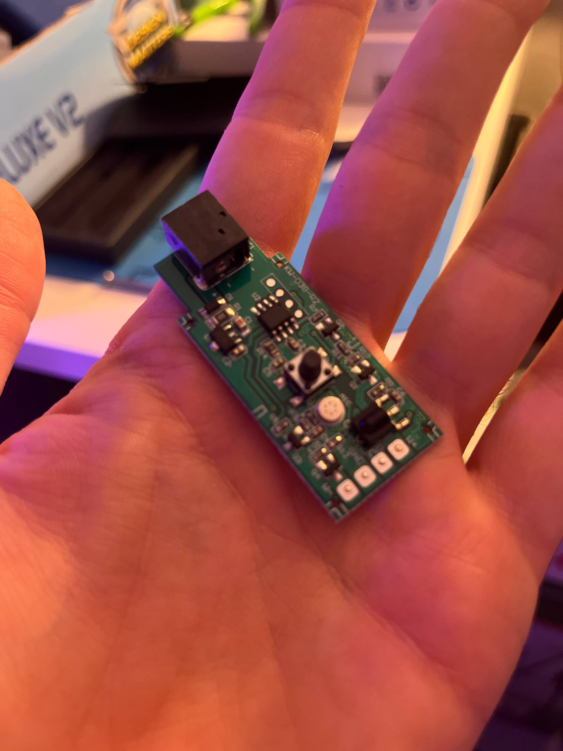

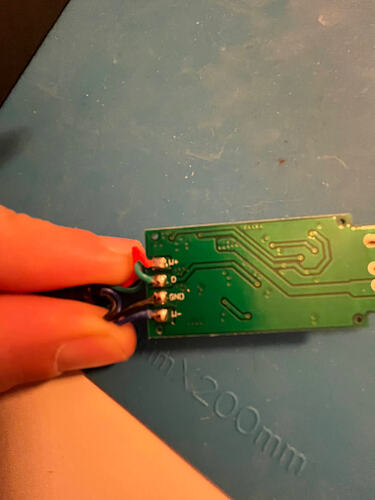

The led bar is Chinese and sold by Action, a fairly new store here in Portugal. Seeing the different modes and effects in person i already expected it to be ws2812b based but there was a white channel in there that threw me a bit off. But anyway, I took it apart and lo and behold, the PCB:
As you can see, there’s one extra pad which feeds about 6 white LEDs on the top channel which I believe was intended as a “reading light” - not that I care about that.
I basically desoldered the original cable, crimped three new ferrules, and hooked it to a wled controller. If you’re wondering which one to get the only important thing to pay attention to is the voltage, this led light is 12 volts.

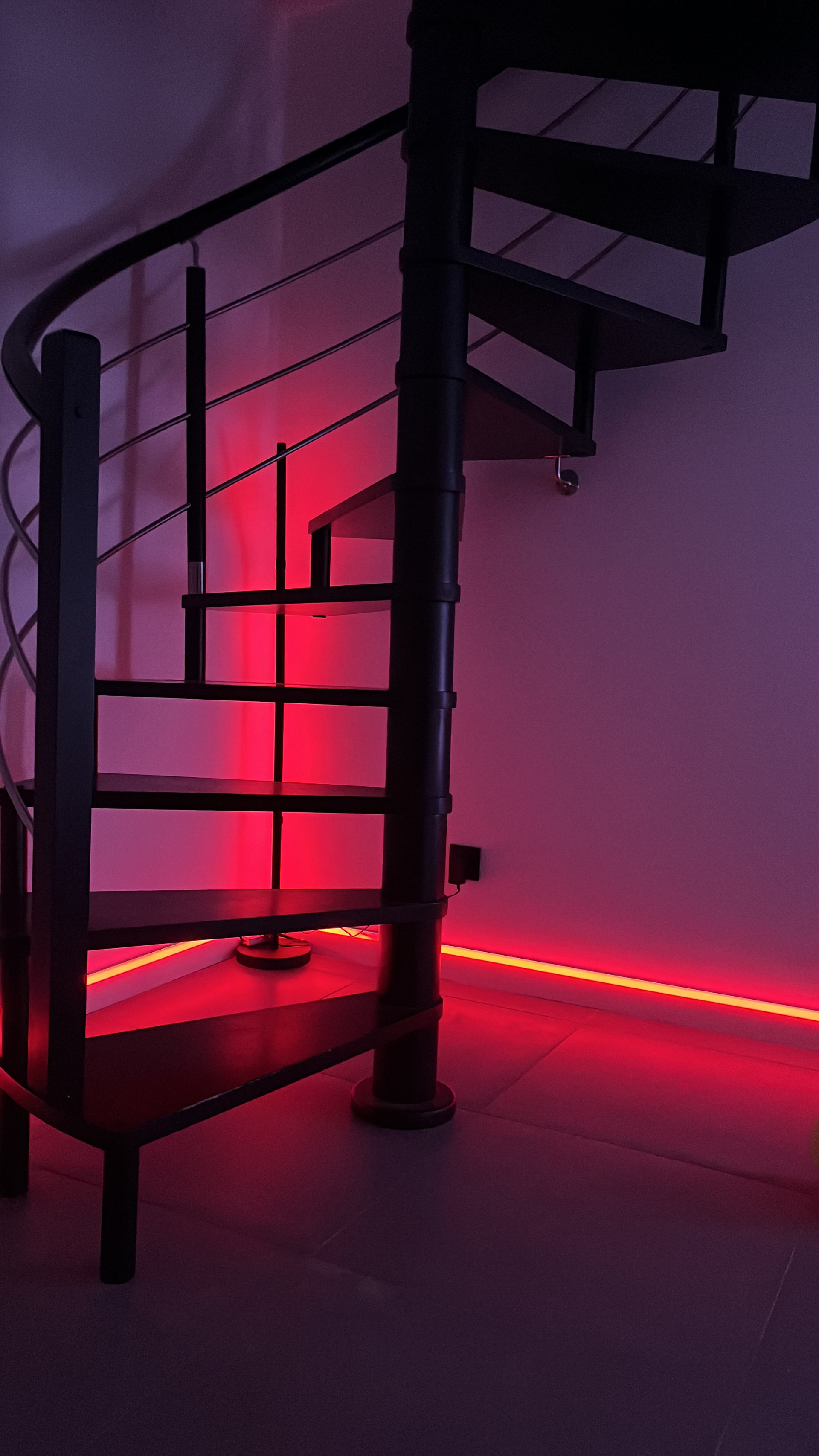

Final picture before my 3yo comes around and destroys it :rofl:
