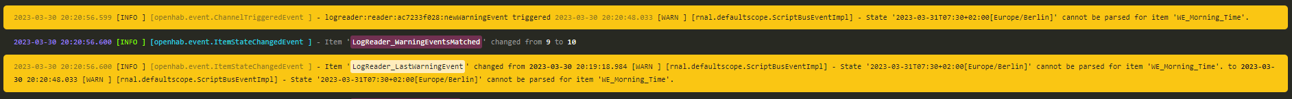

Hmm, when I try to assign a zdt date/time to a DateTime item using a rule, an info message comes up and the value is not accepted. What now? Somehow there is a worm in OH.
Any ideas?
