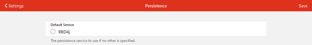

Anyway, it is a little bit strange:
In the system services I did not select the RRD4J option (see picture).
