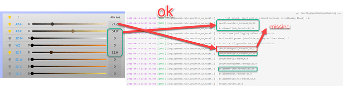

I’d like to have a counter showing how many lights (and similarly windows, too) are currently running (brightness >0). I simply check if a light’s brightness>0 and then increase the counter by 1.
However, this doesn’t work consistently:

The rule is executed when a member of the group Leuchten (Lightbulbs) receives a command or changes (one should’ve been enough, but when it wasn’t working I added another but I guess thats not relevant).

I’d appreciate hints what to look for
