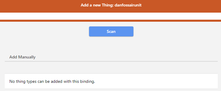

I’ve been building a semantic model using the UI (for now). Last missing piece is my Danfoss Air Unit A2. When trying to create equipment from my existing thing (created through PaperUI in 2.5), it keeps displaying “Loading”:
I didn’t experience this with any other existing things, so I’m not sure if this problem could be within the DanfossAirUnit binding or some bug within the UI triggered by some specific conditions.
Did anyone else experience this, or has anyone been able to add this with success?

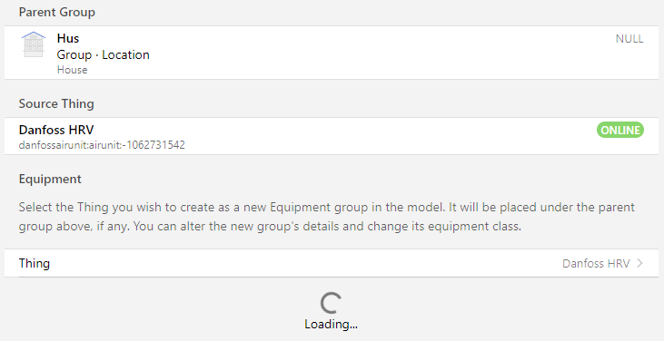

Could you provide the exact steps you did (e. g. the group you created the equipment in).
Anything in the logs?
Please be so kind to open a github issue here and prefix the title with “[danfossairunit]”. You can cc me there as well.
Can I ask one more thing? This might be lack of knowledge from my side, but since I couldn’t reconfigure thing through UI after removing it, I switched to file-based configuration instead, to try to get it back to a working state. This is something I planned to do at some point anyway to have it decoupled from my system and version controlled in Git, now just forced to. So I added (for starters):

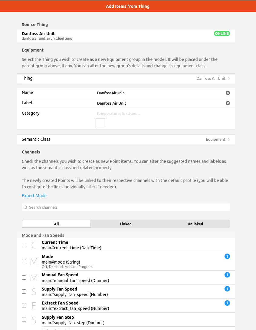

@pravussum - thanks a lot! After installing this version of the binding, I started receiving channel updates again, and I can also set values. So - everything seems to work. Exception is not logged anymore either, after uninstalling bundled 3.0 version.
I disabled my text configuration to test from UI again. It was possible to add thing, and UI started to look normal again. I didn’t try to create semantic model from UI yet, but would expect that to also work now.
