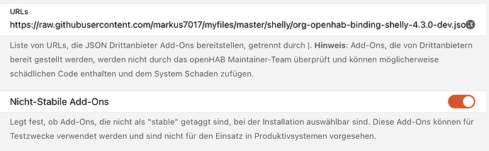

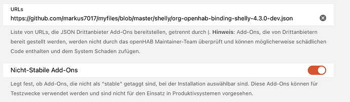

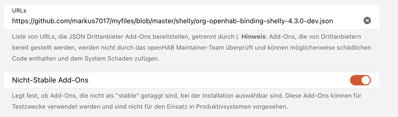

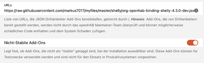

I think the trailing comma at the last line is not allowed in JSON. And you need to use https://raw.githubusercontent.com/markus7017/myfiles/master/shelly/org-openhab-binding-shelly-4.3.0-dev.json, otherwise you won’t get the content of the file but the web view version.

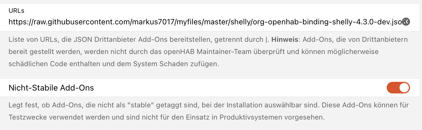

and use
in the setting page.

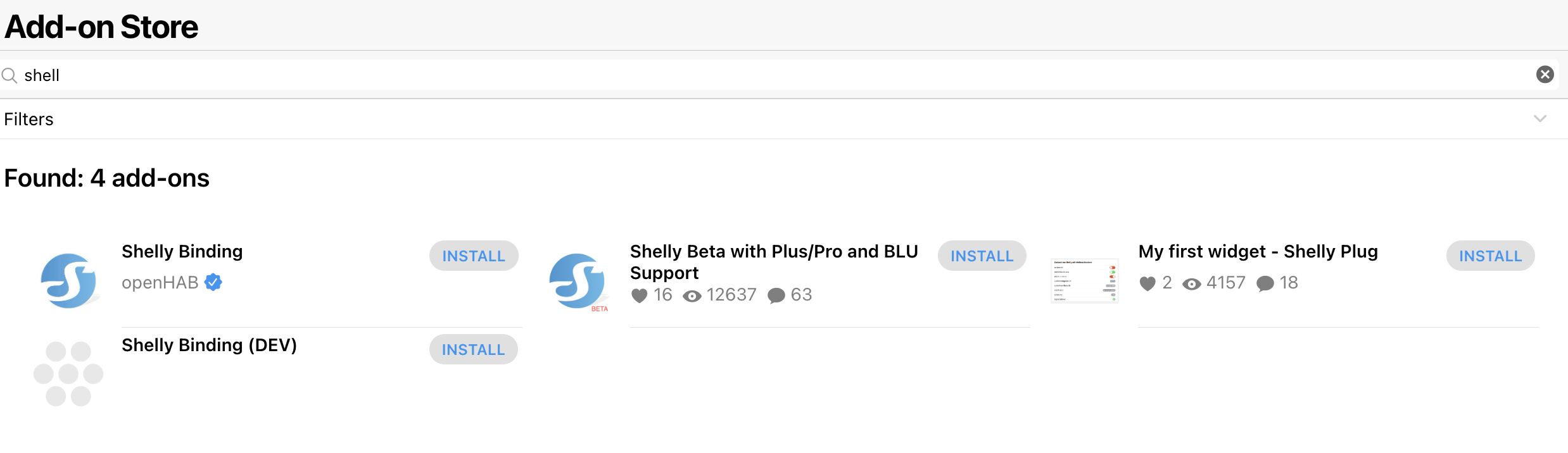

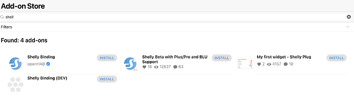

but if I open the Addon-Store and filter for “Shelly” I only see the official binding and the beta one, but not my DXEV build.

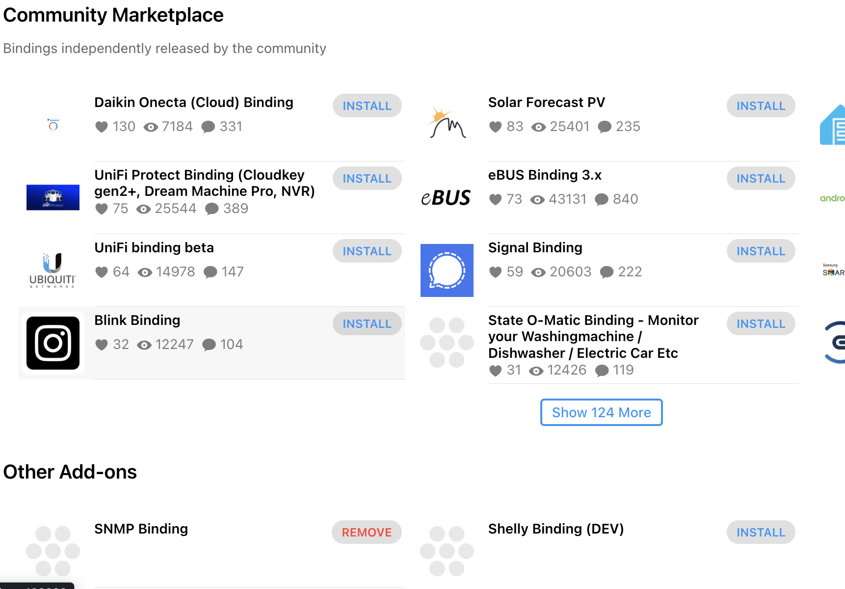

Works for me:
It also shows up in the bindings section:
Edit: the remote JSON is only refreshed every 15 minutes or so, maybe you checked to early after changing the file?
Everything is valid as maturity, but everything except stable will not be shown when the switch is disabled. All UIDs are allowed, the only requirement is that they are unique within a marketplace type (i.e. no second add-on is allowed to have the same UID in all used JSON marketplaces).
you are right, I restarted OH and now I see it, thx
