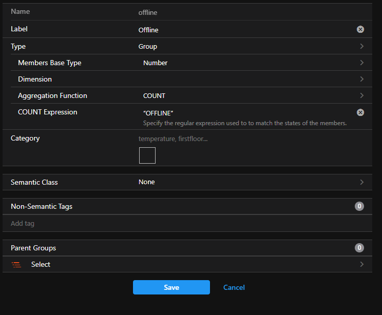

I was able to make a group to count how many items are ON of OPEN however is there a way i can do the same with Things to count how many devices in the group are OFFLINE?
I tried this but it did not yield any non zero results even if group items are offline.
What is the type of the members of this Group? Are their state exactly OFFLINE? The count expression probably should not have quotes. It uses a String comparison no matter the type of the Item.
Thanks for the reply… i think this is where im running into an issue… how do i get the Thing itself in the group. Can i even do that? The Thing is OFFLINE but the ITEM under it just says NULL or the last value.
You don’t. You can’t do that. At least without a rule you can’t. A Group is a group of Items. Things are not Items.
