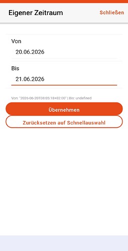

Thanks for the earlier pointer about clearButton — removing it did fix type: date + variable: for a single field on the snapshot I’m running.
However, I’m now hitting a related issue with two oh-input (type: date, variable:) fields in the same f7-list, used for a “from/to” range picker inside an f7-popup:
- component: oh-input
    label: Von
    outline: true
    type: date
    variable: customFromDraft
    label: Bis
    outline: true
    type: date
    variable: customToDraft
Observed behavior:
  • The first field (“Von” / customFromDraft) reliably sets its variable — confirmed via a debug Label showing JSON.stringify(vars.customFromDraft), which correctly shows e.g. "2026-06-18T10:31:30+02:00".
  • The second field (“Bis” / customToDraft) visually shows the selected date in the input (e.g. 20.06.2026), and is highlighted with what looks like an orange focus/validation outline, but vars.customToDraft stays undefined no matter how many times I reselect it.
  • This happens consistently regardless of the order in which I interact with the two fields (tried Von-then-Bis, Bis-only, and alternating multiple times).
  • I also tried adding value: =vars.customFromDraft / value: =vars.customToDraft bound back to the same variables (thinking it might help restore state when the popup reopens), but that made things worse — possibly because the reactive value re-evaluates on every variable change in the widget and may be resetting the native input’s internal state for whichever field didn’t just change. Removing value again, the first field still works but the second still doesn’t.
This is on a recent snapshot build, not 5.1.3.
Questions:
  1. Is there a known limitation with multiple oh-input type:date + variable: instances inside the same f7-list/oh-repeater-free static list? Could the variable-binding fix (PR #3978) only have been verified for a single instance?
  2. Could this be a Framework7 calendar/native input event collision when two sibling date inputs without distinct otherwise-set props (no clearButton, no value) live in the same list?
  3. Is there a recommended way to give each input a more explicit/unique binding (e.g. some kind of id or key) to rule out the two fields’ internal Vue/F7 component instances being conflated?
Happy to share a minimal full-widget YAML reproduction if useful — this is for a “pick an arbitrary from/to range” popup extending the well-known Grafana time-range-picker widget.
Thanks again for the quick help so far!
@JustinG ALSO: This text is not AI it’s human generated :slight_smile: How do I mark it when a human produced the text?

Since your minimal repro didn’t show the bug, there must be something specific to my actual widget structure that triggers it — possibly the nesting depth, the f7-popup + f7-navbar wrapper, or the sibling debug Label component that re-renders on every variable change. Posting the full widget below so you can see exactly what’s different from your repro.
Structural differences from your minimal repro that I suspect might matter:
  • The two date fields are inside an f7-popupf7-blockf7-list, not directly in the card’s default slot.
  • There’s an f7-navbar as a sibling slot inside the popup (for the title/close button).
  • There’s a second f7-block immediately after the f7-list, containing a debug Label whose text expression reads both customFromDraft and customToDraft — this re-renders on every keystroke/selection in either field.
  • The “Apply” button references both variables together in a single actionVariableValue ternary expression.
If you have a moment to drop this exact YAML into a test instance, I’d be curious whether it reproduces for you too. If it does, that narrows it down to something in this structure; if it doesn’t, then it’s likely something environment-specific on my end (browser, theme, locale — running Chrome desktop, German locale, if that’s relevant) and I’ll dig further on that side.
Thanks again, sorry for the back-and-forth!

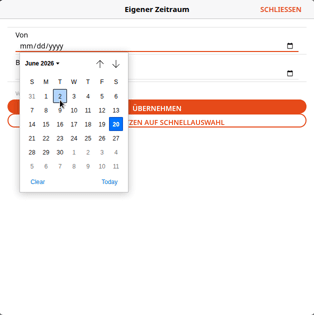

Your popup works just fine for me on both Chrome and Firefox:
inputtest
Mhhm strange… anything I can do cleaning the cache?

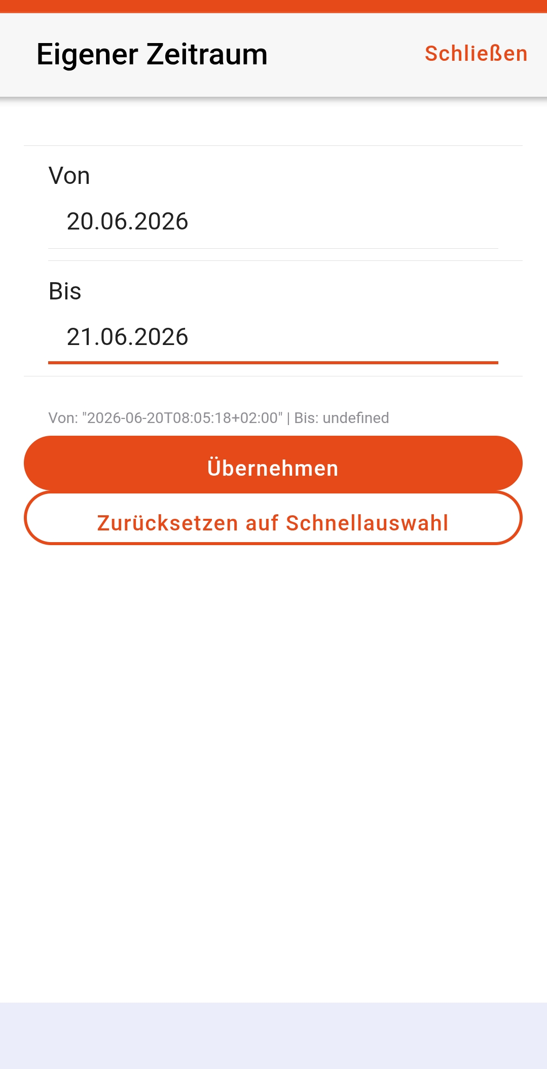

@JustinG on my mobile it runs fine but not on my desktop browser
Also not working on my mobile
it only happens with the date selection - interesting all others are working
Do you see any errors in the browser console when you try to set the second date?
No error nothing
Then I don’t really have any more specific suggestions for you, unfortunately. Here are a few things I would try to see if I could understand what’s going on:
Maybe make sure you’ve cleared the cache on your browser page.
You could test to see if datepicker works better instead of date for the input type.
You could switch the order of the two inputs and see if it is specifically the second input that doesn’t work or the input with the customToDraft variable that doesn’t work.
See if the input works with an item and sendButton instead of a variable.
Okay so I found it out how it works if I press not the actual date but the day before and after that I can select the current date
