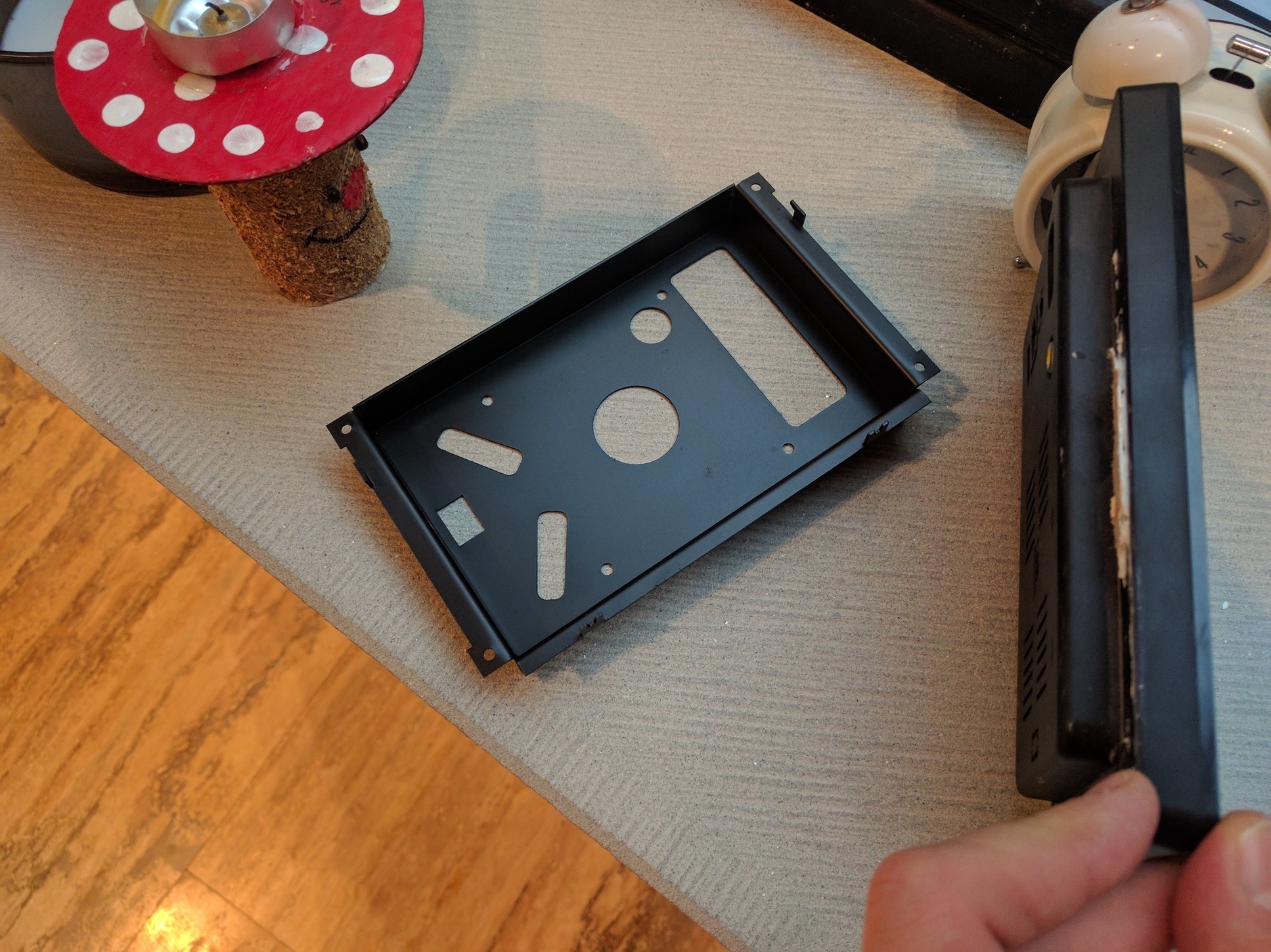

That is SIBO S896s, it has in wall metal frame and install flush with wall.
POE over Ethernet jack , so no need for wifi. and I can reboot them with one click from the switch or ssh.
Downside is that is 180 USD and they have quality issues as out of 8 i have one had bad screen and one has backlit bleeding issue.

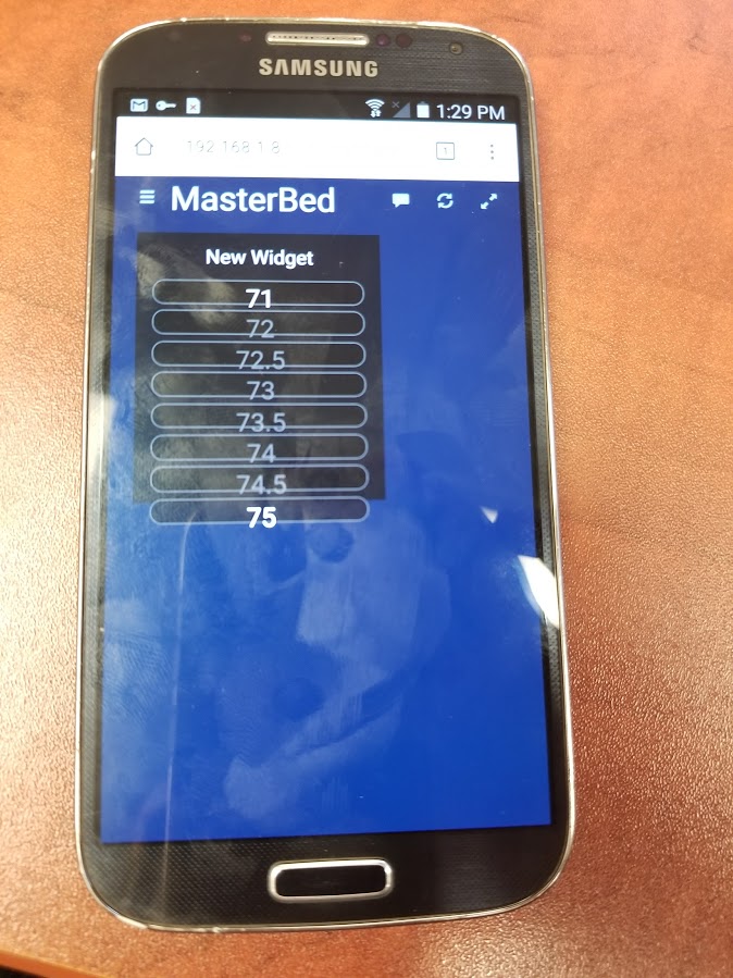

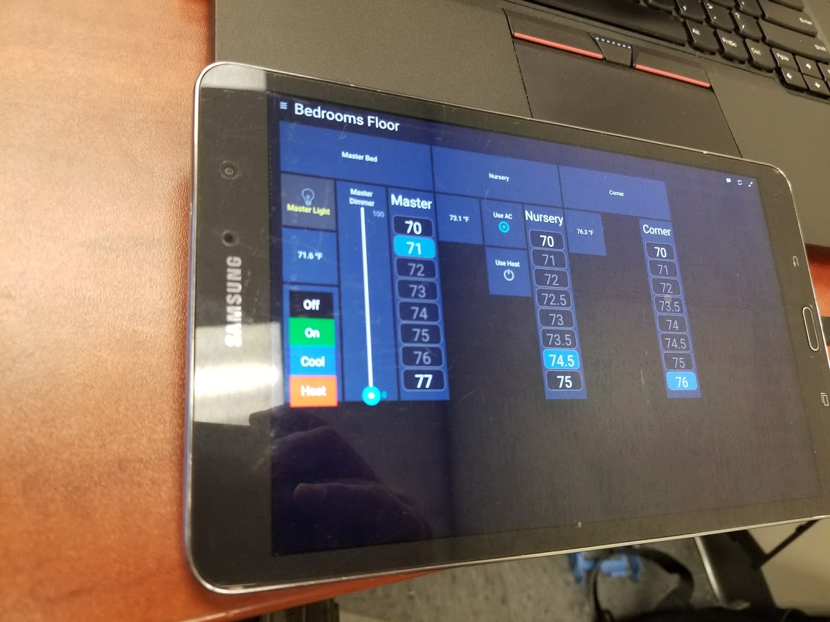

I’ve started using this and I really like it. I’d like to adapt it to the portrait mode of a phone so that I can have individual phones (panels) in each room for control. Problem is, i dont know what the heck im doing. How can I make this fit right on a phone?
works good on a tablet, though!
I think that that due it will not work properly in portrait.
The widget must be 3 or 4 spans wide and 8 high.
I do not know what size is the canvas size when you launch it on the phone

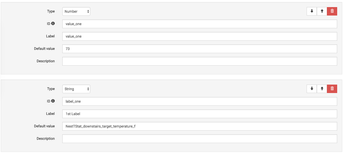

When configuring this to work with the Nest binding, where would I place the nest thermostat item to be changed?
This is what I have to the first button:
23 AM
This is the settings tab for it that I think I’m butchering:
20 AM
This is what it looks like currently:
02 AM
Would I do something like:

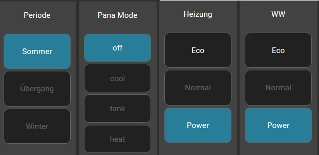

Cool, thanks for sharing. I did the controls for my heating (panasonic MDCF3E5) with it. It’s pretty cool, as there are no ā€œtri-stateā€ switches around otherwise.
U got exacly that one as .json? @MuenchowT
@Marko_Kraft: See attachements. I don’t know anything about web stuff (html, js, etc). But I played around with the font sizes (by guessing), and it also fits pretty good on a standad 10" tablet now. There is a version with three buttons and another one with four buttons.
tri-state-button.widget.json (6.1 KB)
four_state_button.widget.json (7.8 KB)

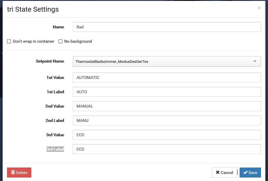

What have I done wrong? Do you have to change the items in the HTML file? When I choose setting Item - for a heizung like yours I get only empty boxes. How habe you done that?
@Marko_Kraft
Hi Marko,

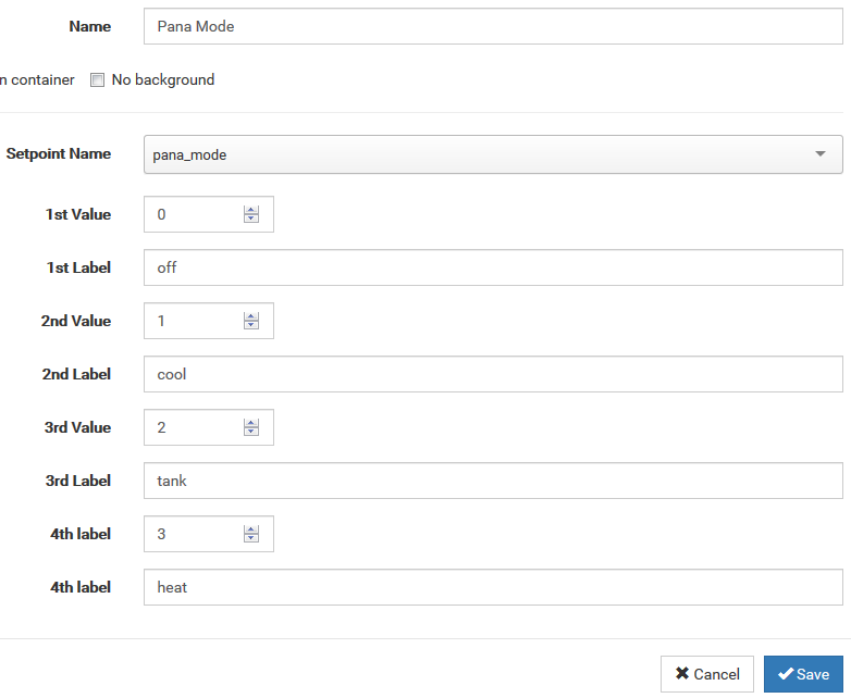

I think, you’ll need to configure the boxes before.
Let’s say, you add one of the custom widgets (e.g. four-state-button) to some panel.
After that, go to the newly added wigdet and ā€œeditā€ this widget.
You will see the following picture, but without any content. You will need to specify Values and Labels (1st,2nd,3rd,4th). The box ā€œsetpoint nameā€ is the item name that will receive the commands when you push the buttuns.
I just tried is myself.
got it
Thanks for the .json and the advise. It would be awesome if there was a setpoint name for each item.
But that“s nothing for me :slight_smile:
hmmm is doesnĀ“t work with states…itĀ“s always sending the number 0, not the state Automatic
Got it work…works now :wink: Thank you @MuenchowT
