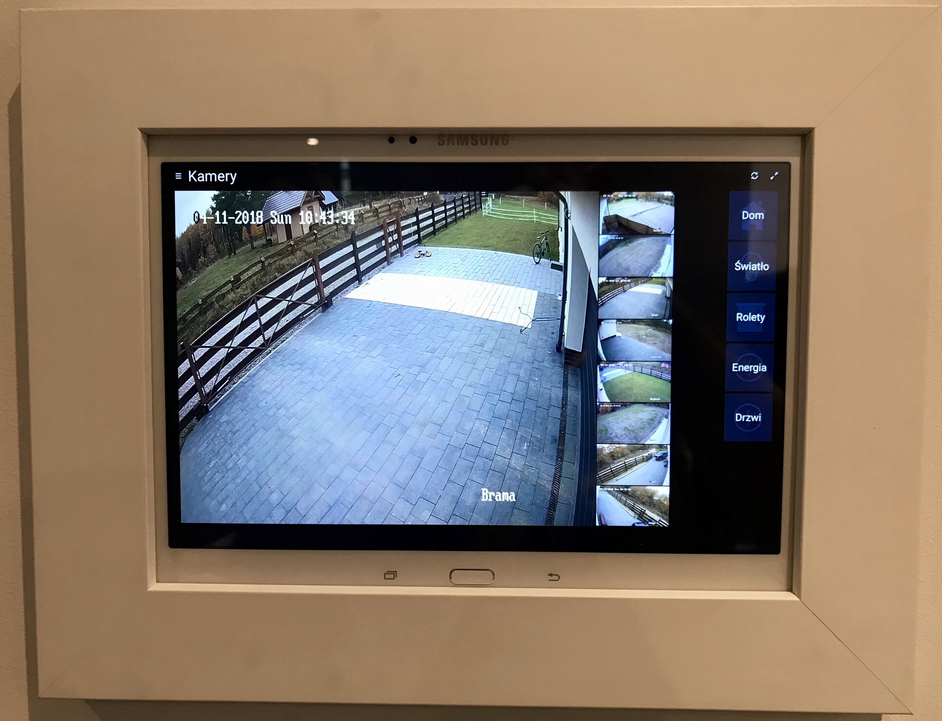

I’d like to share a widget I made to view cameras. I have a set of Hikvision IP cameras, which are transmitting video to a central DVR. I wanted to be able to see a picture of the individual cameras on a tablet in my kitchen, where the windows don’t overlook one part of the house.
Cameras can export current picture as a static jpg through a web path:
http://<user>:<password>@<ip>/Streaming/Channels/1/picture

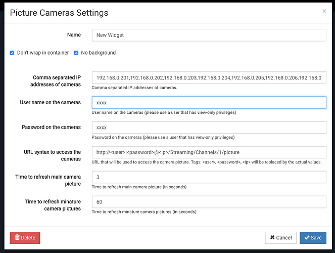

  • Widget allows for configuring any number of cameras (I have 8 and it looks ok with 8 or smaller number, I have not tested more than 8).
  • The central part of the widget shows the currently selected camera view and refreshes the picture periodically (configurable).
  • The right part of the widget shows miniature views of all cameras in one column and they also refresh periodically (another parameter - probably much less frequent refresh is ok).
  • Clicking on a miniature will change the main camera view.
  • I suppose it can work with other vendor cameras too, which export static picture over web, so there is a parameter to define the web path to the picture in the parameters

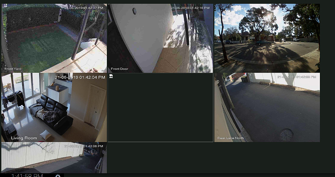

I like the way you’ve laid out your cameras Pawel, are these videos or static images? How do you get around the HabPanel issue of displaying more than 6 or 8 cameras - I find thats the maximum
Hi. The widget does not use camera items but reads static images periodically from the cameras. There is no limitation to that.
But I personally resigned from using this widget and switched to the binding mentioned above. It is enough for me to show just two cameras. Does not look that nice but works well.
Thanks Pawel
Why can’t you use both? Does it require a url to work? if so I could add that ability as someone has requested the ability to ask for jpg files through the binding with urls.
What causes this limitation? I have never tried that many so what happens when you try?
It just displays a grey box and wont display the video feed
Hi matt
see attached, you can see one doesnt load and its also missing 2 other cameras. It’s not a camera issue but a limitation it appears from my searching. If the is a way around this! That would be great
When you change it from 6
you get this. Issue is, I cant get HabPanel to do this, but it works fine using a Mozilla PC browser.
