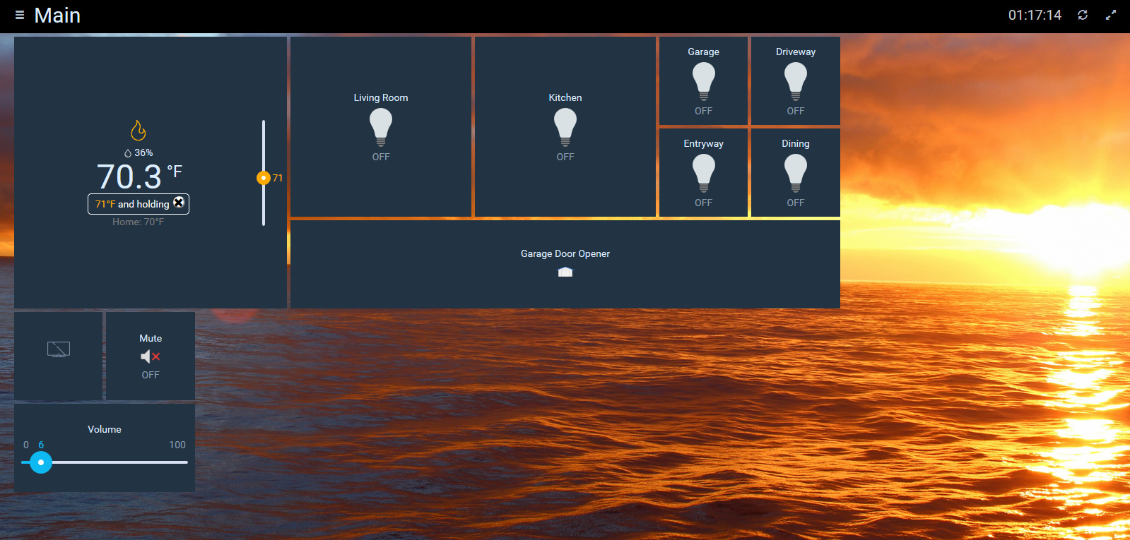

Thanks for all of this, but my question is how do I use that? Currently I have the ecobee bindings from the bindings section and working on basic ui, but I’d prefer this and I’m unsure how to incorporate this into my sitemap.
thank you

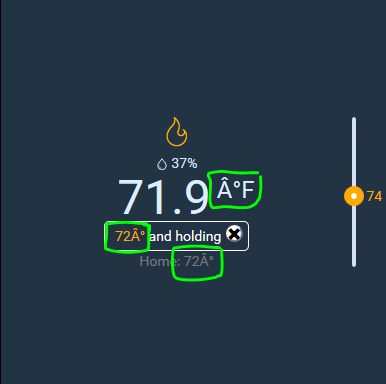

Why is mine like this?

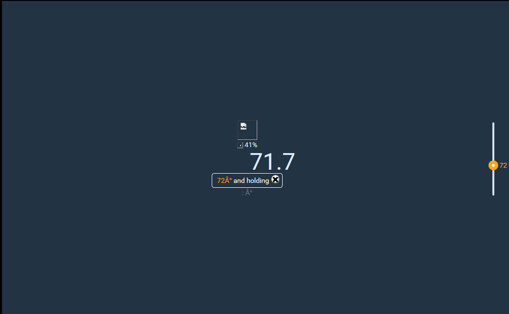

The now its correct its showing 72 and holding but the slider is still at 74.
Also does anyone know why there is a “A” with a arrow above it before the degree symbol?
Yes, it’s a problem in the widget itself. I’ve made some update, if the op doesn’t mind. Now, it use the “UseCelcius” properly, and doesn’t display bad info. Also, the slider for cool and heat have been modified to have dynamic value. You need to set the min and max value for heat and cool in the widget settings. On auto, it use the min value of cool and the max value of heat. These value should match the value from your ecobee settings. Using these settings instead of fixed value prevent the problem that using Celcius, you get a NaN in the slider because the value aren’t converted to Celcius.
