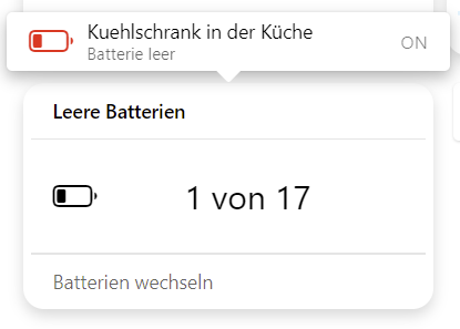

HI @RGroll, I have a follow up question. If i have 2 or more similar widgets in a site with the same popup and only by clicking again it shows the right one. this is a repeatable story. Is there a way to prevent this behaviour?
what do you mean by this?
I thought, I stick with the predefined layout of the basic oh-cells/oh-cards, e.g.:
… and just bother with some “details-widgets” as popover or popup to get a simple but similar look of the “top-level” UI elements.
Therefore I had a oh-label-card component in the above example with popover action.
If I can’t do this (because the missing styling options for the popover) I can still build the same look using the native f7-grid components.
Not a big deal - but some more work :wink:
got it, true. I ended up in just using custom widgets :-), but i any way wanted more control over backgrounds, content and highlight colors… as well as usable for iphones
I think, I’ll follow this too though…
Some hidden limits with the oh-* components may cost more time than it saves - finally … :wink:

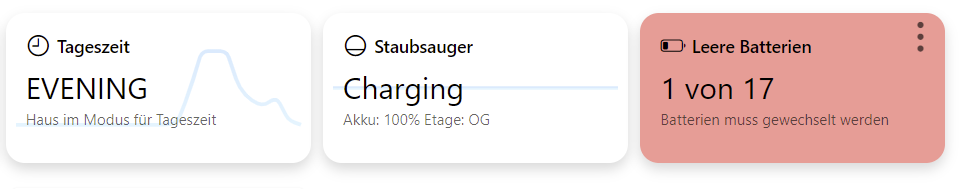

I’ve put a f7-button over the oh-label-card:
component: f7-card
  outline: false
  noBorder: false
  padding: true
  noShadow: false
  style:
    --f7-card-margin-horizontal: 5px
    --f7-card-content-padding-vertical: 0px
    --f7-card-content-padding-horizontal: 16px
    --f7-card-border-radius: 15px
    --f7-card-box-shadow: 0px 5px 10px rgba(0,0,0,0.15)
    --f7-card-header-font-size: 14px
    --f7-card-header-font-weight: 600
  default:
    - component: oh-label-card
        title: =(props.titel) || (props.mainItem) || "Set properties.. "
        icon: =(props.icon || "f7:battery_25")
        label: = (items[props.mainItem].state + " " + props.delimiter + " " + items[props.secItem].state)
        footer: =props.footerText
        noBorder: true
        noShadow: true
    - component: f7-button
        action: popover
        popoverOpen: .detailList
        style:
          position: absolute
          top: 0px
          width: 100%
          height: 100%
        default:
          - component: f7-popover
              class: detailList
              closeByBackdropClick: true
              closeByOutsideClick: true
              backdrop: false
              closeOnEscape: true
              style:
                --f7-popover-width: 320px
                --f7-popover-border-radius: 4px
              default:
                - component: oh-list
                    default:
                      - component: oh-repeater
                          for: i
                          sourceType: itemsWithTags
                          itemTags: LowBattery
                          fetchMetadata: semantics,widgetOrder,uiSemantics
                          filter: loop.i.state != "OFF"
                          default:
                            - component: oh-label-item
                                icon: f7:battery_25
                                iconColor: red
                                footer: =loop.i.label
                                title: =loop.i.metadata.uiSemantics.config.equipment + loop.i.metadata.uiSemantics.config.preposition + loop.i.metadata.uiSemantics.config.location
                                item: =loop.i.name

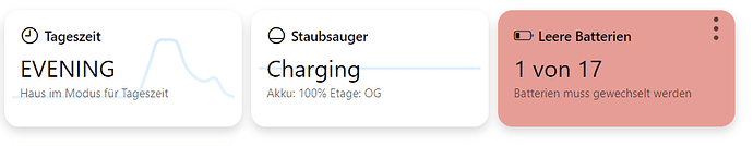

Can you please explain me how did you count the item state ( 0 von 17) ? :slight_smile:
Sure :wink:
That’s a good question, since the solution is not that obvious in openHAB3 :wink:
When checking the documentation for aggregation functions you may have noticed the COUNT() aggregation:
Unfortunately, the COUNT() aggregator is not selectable in the MainUI of openHAB3.
BUT: You can work around that limitation by importing group items with COUNT() aggregators from textual configuration:
This essentially adds two groups where one counts for empty and another count for good batteries.
A third group simply sums up the both which provides me the total number of batteries:
NumOfEmptyBatts + NumOfGoodBatts = TotalNumOfBatts
All BatteryLow-items belong to both count-groups - that’s it :wink:

Let me come back to this post from you Rainer: What you are doing there is fine since you only have static text in the popover. As soon as you want to show some item related info or controls in the popup I can confirm now that this does not work reliably. I have the following scenario:
I have two instances of the same widget on the same page. Both widgets try to open a popover which in turn shows stepper controls for a number item (I’m talking about my light control widgets). Since the class of the popover is hard coded in the widget there is no way for the browser to determine which element in the DOM should be displayed when you click in the link that opens the popover. I just realised this today when I always saw the popover with the item that was configured in the other widget but not the one I was clicking on.
So the solution still has to be the separate widget then which should work in any case. However I don’t think that anyone has solved the positioning issue yet…
Oh and by the way I tried to work around that by using a dynamic classname by reusing your suggestion from here: New Stylesheet property - #5 by RGroll
Correction - It seems to work like this:
I use the name of the timer item as css class like shown in the code below:
          - component: oh-link
              text: Timer
              visible: "=props.shutdowntimer ? true : false"
              action: popover
              popoverOpen: '="."+props.shutdowntimer'
              style:
                position: absolute
                bottom: 10px
              default:
                    class: '=props.shutdowntimer'
                    default:
                      - component: oh-stepper-card
                          item: =props.shutdowntimer
                          title: Ausschalten in Minuten
This way the class name may not necessarily be unique as you may use the same configuration in different widgets. However you would always open the control for the right item. This feels pretty hacky though since there may be problems when your item name is not a valid css class name or when you are using multiple items in your popover. In this case however you can always add a text property to the widget and leave the setting of a unique class name to the user. This is also not an excellent solution but should do in most setups.
