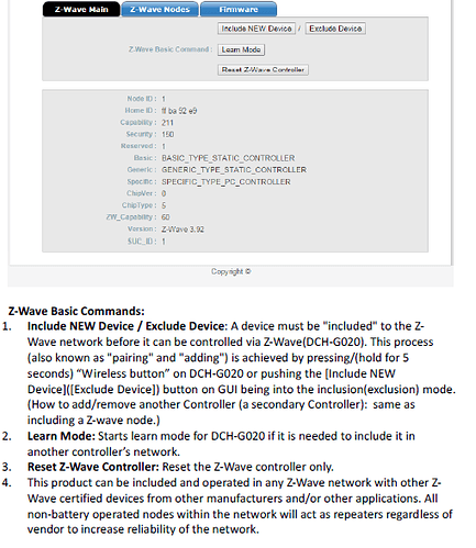

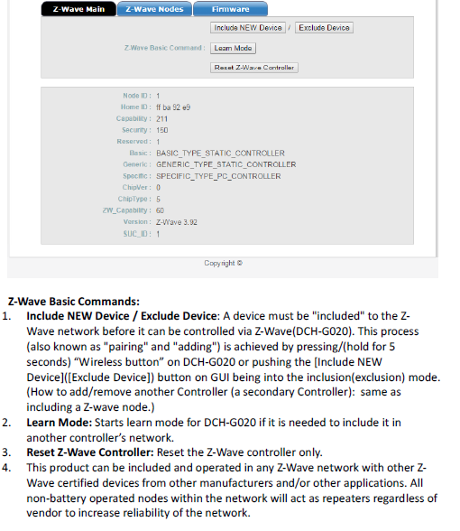

I was looking for some more information and came across these infos:
The device is end-of-life since November 2020. There will be no security patches for DCH-G020 anymore.
DCH-G020 has a limit of 15 devices it can handle. The usual USB Z-Wave controllers can handle app. 230 devices.
From what I have seen in the users manual it is unlikely that a binding exists to use this device with OH. There is a built-in webserver, which basically only allows a firmware upgrade.
