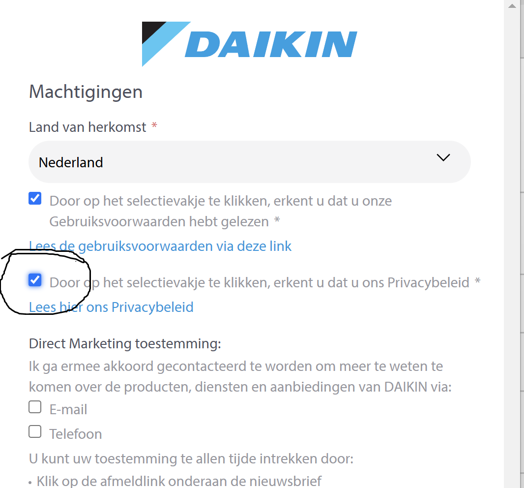

I realized that the IOS Daikin App also stopped working, and I had to enter my credentials again.
Had to acknowledge some news T&Cs, now the IOS app works again. But the Binding is still offline.

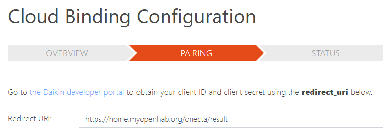

For me the system stopped about a week ago and can’t get it to work anymore. Can you confirm you use the Redirect URL as shown below “https://home.myopenhab.org/onecta/result
I get the following error after pairing.
Hello HenMus,
yes, I used the same redirect URL of yours. Be aware that I repeated all the operations listed in the installation guide posted at the begining, up to delete and regenerate the application on the Daikin portal.

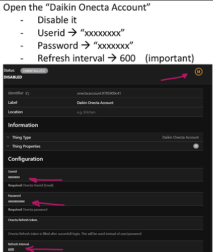

On the screen below from the manual there is a option top right to disable it. Do you see that if you connect to your local instance from the cloud? I don’t have that option. Only when I login with my local ip address I see that option
Second question. What username and password do you enter on the screen above. Your local credentials or the cloud credentials (what you are using to login to https://home.myopenhab.org)?
Hi Nils, can you provide the postman collection? I want to test the Daikin API without the binding.
Hi @HenMus,
I see the dissable option when I login as admin. You only dont see this when you are creating a new thing, as far as i know.
