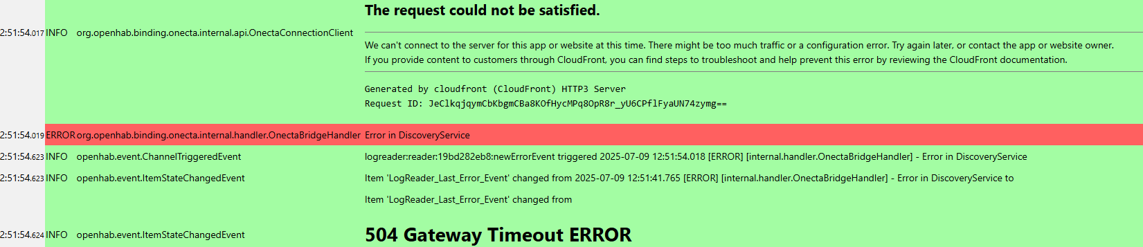

@Alexander_Drent, binding is now online for half a day but no autodiscovery, in the log I get an error in discoveryservice. What do I miss?
@Alexander_Drent, it is working and all airco’s are visible. It was a struggle but it looks great. Many of the advices and comments in this community topic helped but are unfortunately not reflected in the instructions. Let me know if you want to use my learnings for next updates.
