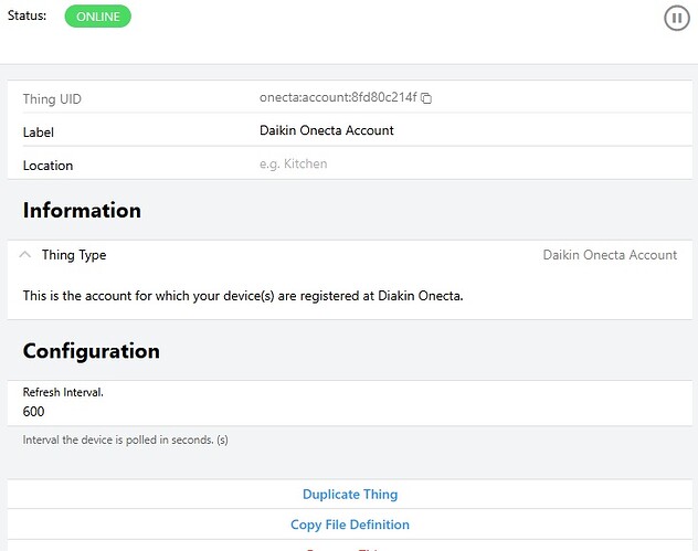

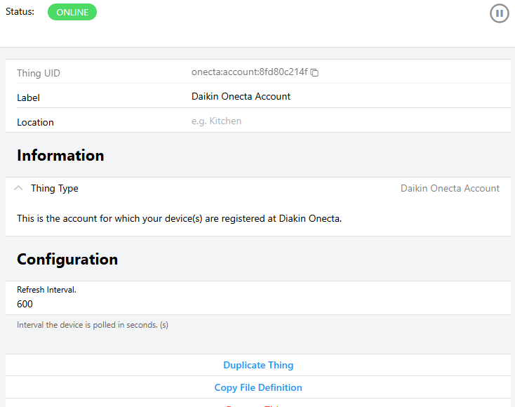

Hi guys,
I have just set a new instance of OH 5 and the only thing I cant get working is the Onecta.
I cant get the redirect to be https - it always reverts to http with :443 in the address :frowning: Manually I can change it, and I get success and Online on the next page.
However also in the Thing - I dont have username /pass section to enter details like what is in the PDF.
I have the onecta Thing online - but what I am missing? Can I change the code to enter this?
