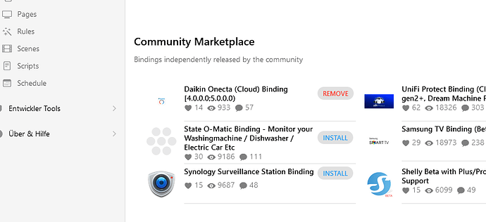

Daikin Onecta (Cloud) Binding [4.0.0.0;5.0.0.0)
You can get it in the Marketplace
thank you Alex, it works great!

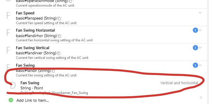

Hi Alex,
the binding is working perfect for me except two little things:
I can not get the two channels for the fan directions to work. I get the information about the actual state of the fandir, but I can’ set it :frowning:
Maybe I’m using the wrong commands. For horizontal swing I’ve tried “STOPPED” and “SWING” and for the vertical swing I’ve tried “STOPPED” ,“SWING” and “WINDNICE”. Should this work or are the any other commands I have to use?
THX
Mike
Hi Mike,
You has found one of the items on my ToDo list :upside_down_face:
Fan Swing Hor and Ver are still readonly, I did not build the update part yet. (honestly i forgot)
But for now you can use and update the “Fan Swing” this is a combination of the hor and vert.
