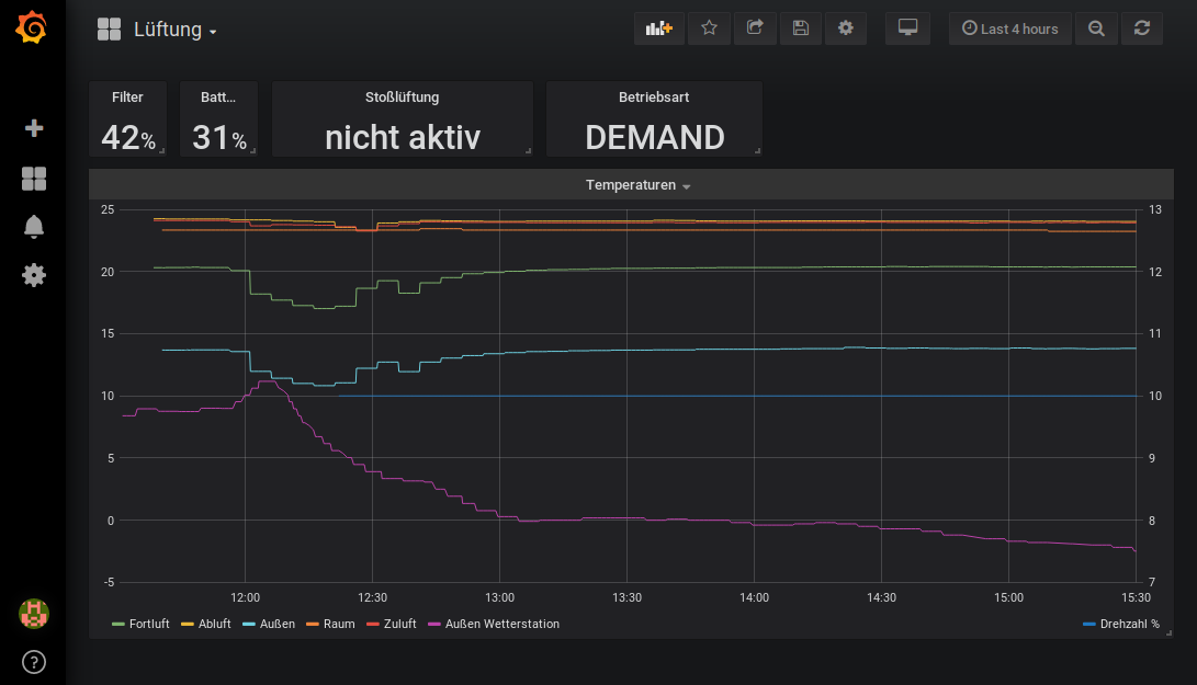

Added some items + persistence rules manually so the stuff is written to an influx database.
Result looks like this:
Only the fan speed does not seem right. It stays always at 10 (%), even in boost mode.
I suppose some conversion issue. I’ll look into it as soon as I find some time, or maybe @leaxi you can take a more educated guess at what could be the reason?
the fan speed of the air unit ist available in certain registers with different meanings and units. I used the register, which allows setting the fan speed in manual mode. This register contains a byte with the values 0 to 10. 0 = OFF, 10 = 100%
As I coded this as a PercentValue state in OpenHab I had to add a rounding, when the user sets something like 53%. This value would bei rounded to step 5.
Question ist now wheter your air unit was running on step 10 or 1 or something else. You can check that in parallel using the air dial.
10 would simply mean a unit issue. 1 would mean correct. Any other would mean Something completely wrong.
