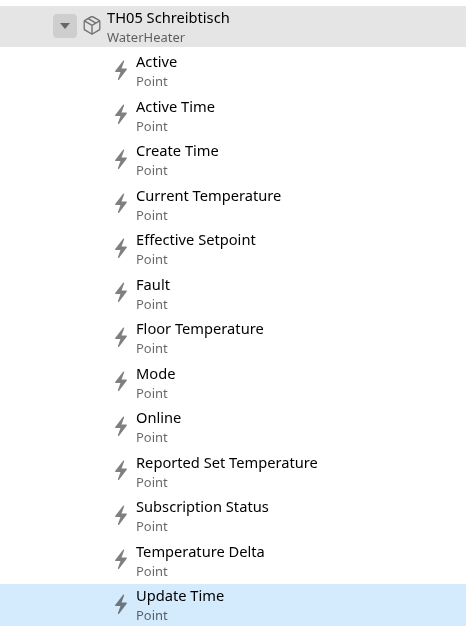

Built a new version with dynamic channels added. Now all items have all channels that the API returns. When updating, existing Things need to be recreated.
Still trying to figure out the API request limits - for 8 devices, 60s polling hits the API limits
New Binding works quit ok, with lots of channels. The temperatures come in as integer values, like 254 means 25.4°C. Is there a chance to make the division in the binding?
No, because this is how the API returns the data. I cannot reliably distinguish, across different devices, whether a value represents temperature or some other metric (for example, humidity).
The channels that belong to the status group will be exposed from API without any transformations.
For thermostats, I calculate separate channels for temperature and setpoint, but I am not fully sure that this logic works correctly for all thermostat models.
