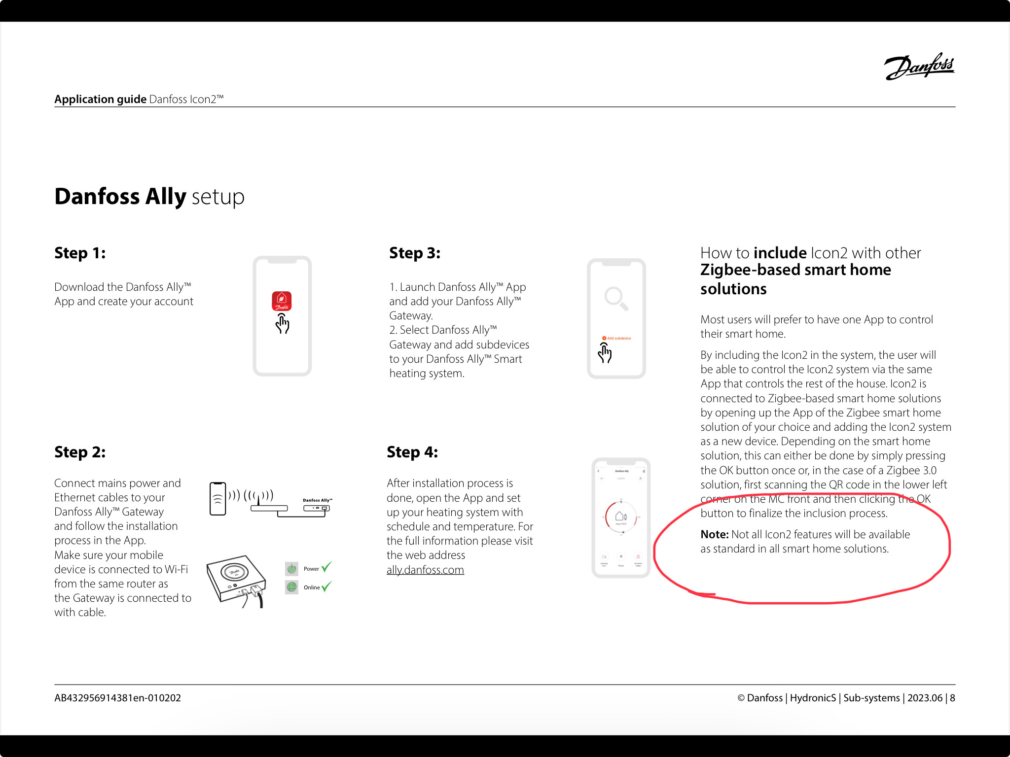

I have recently installed a Danfoss ICON2 heating controller
The device offers control via ZigBee3, and Danfoss provides its own hub Danfoss Ally. Instead of using the Danfoss Ally, I would rather want to connect it to a third-party ZigBee3 hub (e.g. ConBee3) and integrate it with openHAB. As I understand, openHAB would need the bindings for the ICON2, which are not (yet) available. Correct ?

Basically this is my question: How do I know if a specific ZigBee coordinator/hub will connect with the Icon2, and which features will be supported - and if there are missing features, how would one be able to add those.
I am still lacking somehow the understanding which layer is responsible for decoding the frames sent by a device, and what information is required to integrate the provided data in a smart home application like openHAB.
