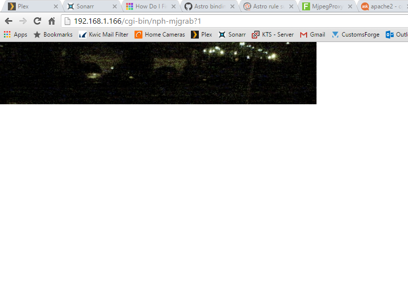

I’m also having this same issue.
I have dashing running well with weather and configured to use my own lights.
I have motion running on a raspberry pi of my front door and installed the nph-mgrab on both my pi and my openhab server in the appropriate /usr/lib/cgi-bin…
Apache2 is installed on both (I wasn’t sure which one it should be installed on so for experimentation I tried both)
I also made sure that my directories are created
(in my case it’s /var/tmp/snapshot1_blahblah)
The make file for the npn-mjgrab on the Openhab server was set to point to the pi’s IP address.
In the cameras.rb file I tried pointing the camerahost, port etc to both the pi’s IP address and using a localhost address (127.0.0.1)
Oddly enough if I try calling the script in a browser
for example: http://192.168.1.148:8080/cgi-bin/nph-mjgrab?1
I get an error showing
Problem accessing /cgi-bin/nph-mjgrab. Reason:
** ProxyServlet: /cgi-bin/nph-mjgrab
Anybody have any ideas?
So I actually answered my own question…
Turns out I had to run this command on a new apache installation
sudo a2enmod cgi
sudo service apache2 restart
and I was able to get it running.
Now I have a really weird issue…
When I call the image - it gets partially cut off
Honestly can’t think of what it might be…
Haha and I seemed to have solved my problem again…
I tried calling the mjpeggrab from within the cgi-bin on the openhab server pointing to the pi camera.
(instead of having it in the cgi-bin on the pi)
that seems to have rendered the whole image.
I’m guessing the pi may have been a little underpowered since there were two cameras on it.
Either way i’m good now
