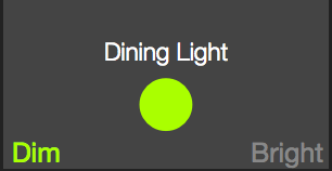

I’ve begun experimenting with some of the different icons available, and was wondering if it is possible to toggle the background color of a widget?
I found how to toggle the background color of the icon itself, but not the widget yet.
In doing some google searches, I think there might be a class ‘status-danger’ and ‘status-warning’ to make a widget pulse as well, which would be pretty cool/neat for alarms.
Yes, its certainly possible to change the widget background colour.
If you want a permanent/fixed background colour, you could probably add something like style="background-color:#452136" into the widget’s div tag in the layout file.
If on the otherhand you want the background colour to be dynamic, depending on the current value of the widget’s state, then you’d have to code it into the coffeescript of the widget and add corresponding scss file entries. Have a look at the Ohalert widget which does exactly that - I use this widget to show visually when one of the outer doors are left open and so it’s background colour changes depending on whether the state of the openHAB item is open or closed.
@smar - Thank you for the tip to look at the ohalert widget. It turned out to be easier than I thought.
I ended up changing the ohswitch to use a lightbulb icon and then toggle the widget background if the light is on or off.
Still learning all of this, but its ‘fun’.

I created a simple two-way switch as I have a light I use two settings for - dim & bright:
Anyone interest can download the widget here - https://drive.google.com/open?id=0Bwfvf57HSA1oS2hKeE5SYlFYY3M
