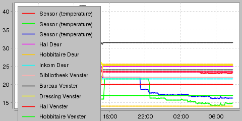

I’ve also noticed that in my temperature graphs, I’m now getting descriptions as ‘sensor temperature’, and no longer the description. I guess these are the sensors I’ve already linked manually. The others don’t work anymore at first sight.
Not sure if I can/must relink all items in paperUI, or is there more wrong?

I guess that the system has auto created items for all channels not linked to items (so called simple mode) so you need to relink your items to sort out the names.
