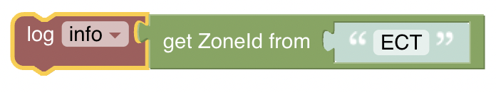

I am almost done with porting your blocks to blockly core. You lately added the following block to the library. I know what it does but I wonder what you/we need it for. Can you provide an example?
returns
Europe/Berlin
PS: I did not add your “set item” as it can be achieved by using a generic post-command-block (I do understand that you added it for convenience though in your library). I also combined blocks 4-6 into one block which is much more versatile but couldn’t been done with the block library because it uses mutators. I also added e.g. small additions like milli seconds support. Other than that the new blocks are very much based on your ideas and your work - so this is very much appreciated and I will add that appreciation to the PR that will come eventually.

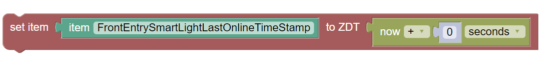

After migrating to OH4, a rule I had written a while ago and hadn’t thought about failed. I was able to figure out that it was the “set item” block that caused the failure:
2023-07-30 08:51:49.263 [ERROR] [b.automation.script.javascript.stack] - Failed to execute script:

2023-07-30 08:51:49.334 [ERROR] [internal.handler.ScriptActionHandler] - Script execution of rule with UID 'SetFrontSmartLightTuyaStatus' failed: org.graalvm.polyglot.PolyglotException: ReferenceError: "events" is not defined
and the code from the UI
events.sendCommand('FrontEntrySmartLightLastOnlineTimeStamp', new deibich_blockly_DateTimeType(time.ZonedDateTime.now().plusSeconds(0)));
for block
Changing to the post update block fixes the problem.
