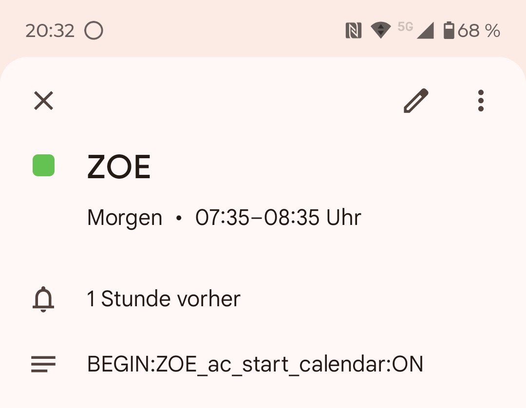

Not an event Channel (as far as I can tell) but you can configure the calendar entry command tags to command an Item from the calendar entry. iCalendar - Bindings | openHAB
Configure the calendar entry to send a command to a Switch or something when the event ends.
Yes, you can command for example a switch to ON at the beginning of that entry
I start hvac for our car that way.
You can also command something at the end of the entry …
I see. So that’s just a string in the calendar event? I’ll give it a go!
That sounds reasonable, indeed.
A string in the notes section of the calendar event.
