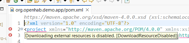

Debugging binding outside of OH repository
I’m not sure what to make of this. It looks like most of your changes were already the standard in my pom.xml, as pasted here. I also didn’t find a <parent> tag…?
Anyway, I did git reset --hard origin/main and then git clean -fdX, so I think I’m at a “fresh” start. That also cleared all the jsondb files you mentioned here:
I now used this:
<?xml version="1.0" encoding="UTF-8"?>
<project xmlns="http://maven.apache.org/POM/4.0.0" xmlns:xsi="http://www.w3.org/2001/XMLSchema-instance"
  xsi:schemaLocation="http://maven.apache.org/POM/4.0.0 https://maven.apache.org/xsd/maven-4.0.0.xsd">

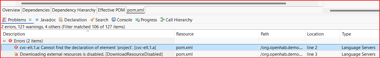

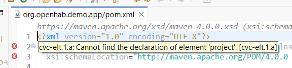

There are still two errors… The upper red dot with cross reads this:
The lower reads this:
Or, apparently also visible below:

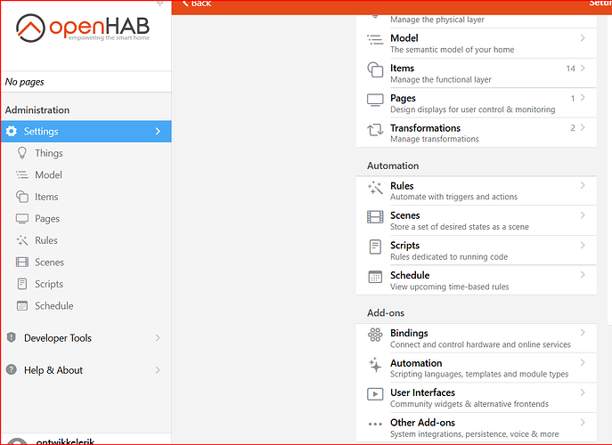

I then went through all your steps:
Alas:

This is from Eclipse itself, it’s a “security feature” to prevent XXE attacks, but like so many such things, it also prevents things from actually working. So, you must find a way to tell Eclipse that it is allowed to download external resources. I had the same thing, but I don’t remember exactly where I clicked to “allow it”. But I think I right-clicked the error somewhere (in the editor or in the “Problems” view) and selected “Quick fix” where the suggested quick fix was to allow downloads.

@ErikDB Try Eclipse:Settings:Maven → tick “Download Artifact Javadoc”
I had the same issue in the past and from my pod it has nothing to do with Javadoc files, but that time it helped.

I jumped through some hoops, but got the same red, and thus scary looking, logs. But it turns out the GUI was operational. So maybe it all worked before as well? And I should have looked past the red logs…?
We’ll see where I get.

Then I ran mvn clean install -e -T1C -DskipTests -DskipChecks -Dspotless.check.skip=true again in the external binding folder.
I did this, and the errors went away, indeed.
I did this as well.

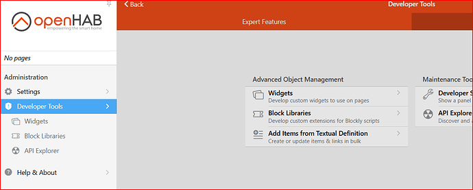

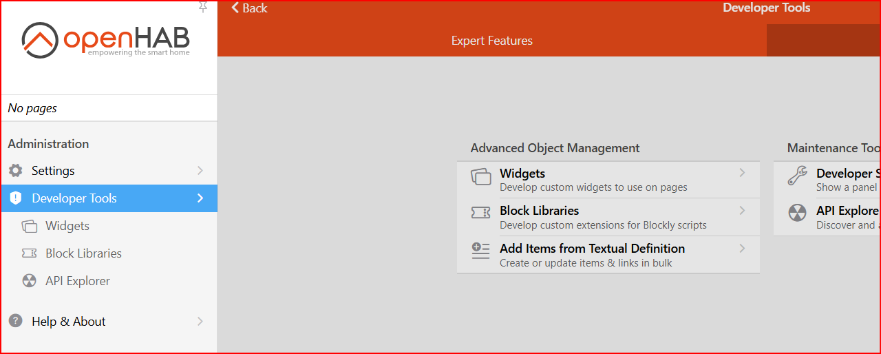

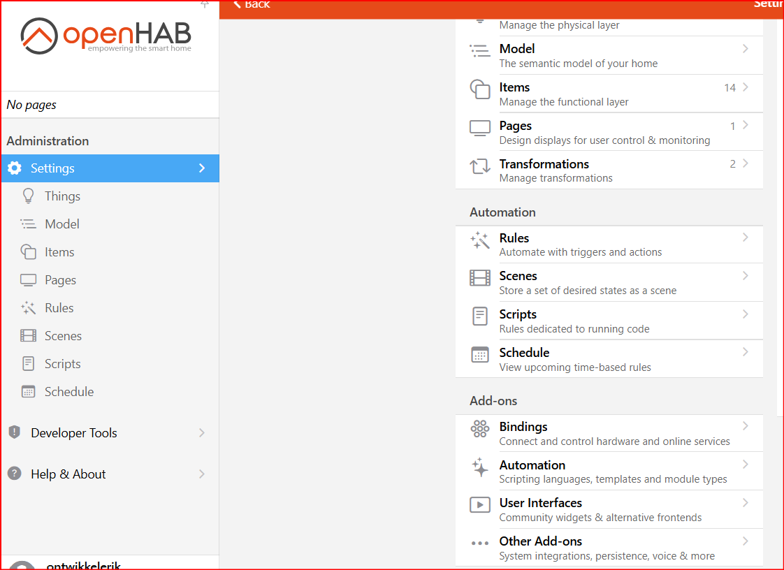

I wanted to test whether the binding was installed, but I don’t see the add-on store:

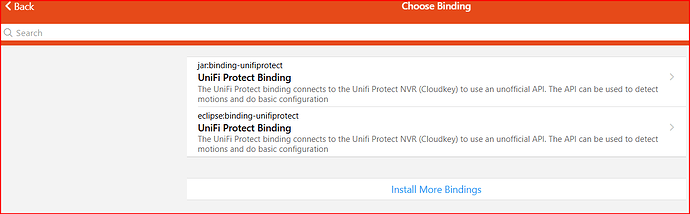

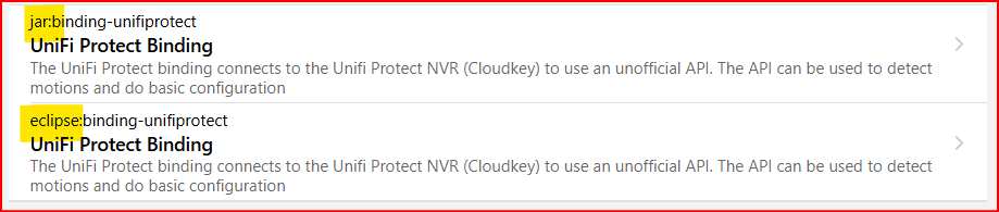

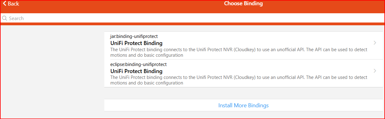

And when trying to add a thing manually, there seem to be two bindings installed:
Mysteries, mysteries…
Also, I now don’t know which of the two bindings is the one that will give me something to debug.

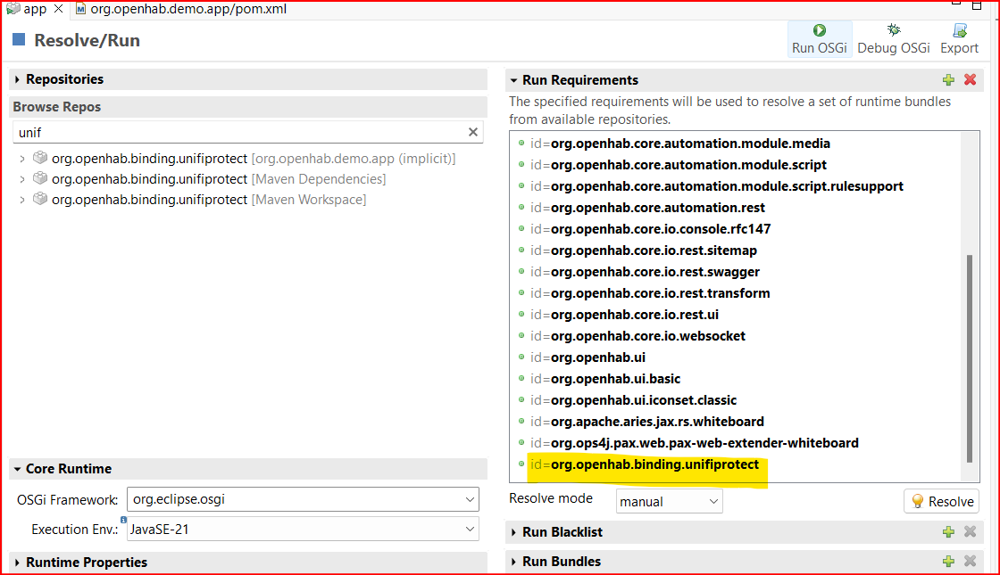

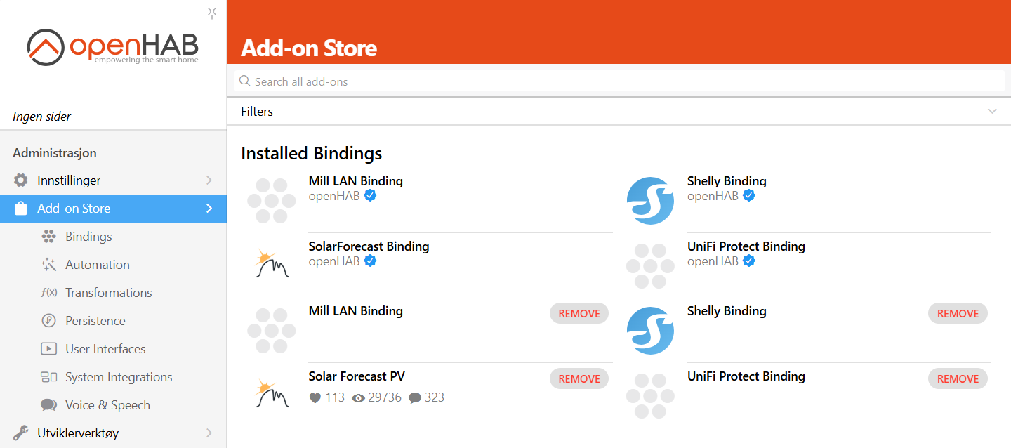

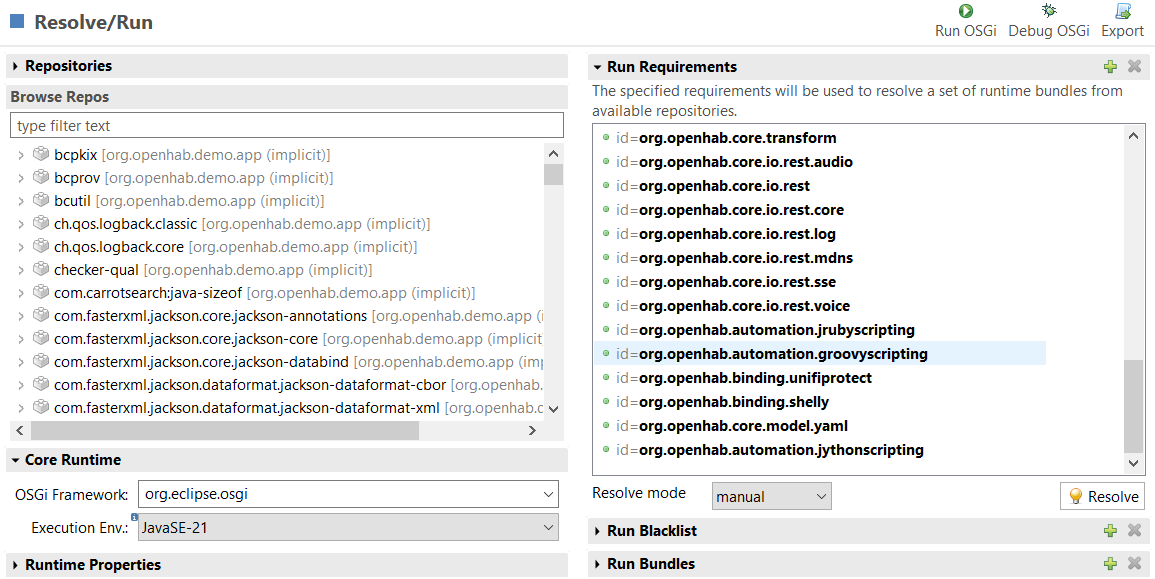

For the binding to be “installed” you have to add it to the dependencies, then add it to the “Run requirements” in the “Resolve/Run” window:
(just like I did with jythonscripting here)
Once that is done, you must click “Resolve” and hopefully get a successful resolution. If you do, click “Update” (I think) and then save the project. Then you can start OH with “Debug OSGi”.
I’m sorry if I’m repeating something that you have already done, but it seems to me like you might have excluded this important step.

It’s added. I also changed the “version” to 4.0.0-SNAPSHOT on line 9.
I went through all those steps, and:
I also went through that list, to check whether that binding is in there twice… But no.
But the demo app now acts like there are two identical (?) bindings, where I only expected one. Also, there’s no add-on store, which seems strange?

No idea why a temporary directory can’t be created (see the last WARN) and whether that’s relevant…?
Aha, I see the add-on store (or what is it called) now:
I also see a difference between both bindings: one says “jar”, and the other one “eclipse”:
But which one to use in order to get some debug logs?

That’s normal, I always use the “jar” one and ignore the “eclipse” one. I assume that there’s another way it should be possible to do this without having to add it to the POM and all that, using the “eclipse” version, but I haven’t bothered trying to figure out how to get that to work.
I still don’t see it in your screenshot, but given that you’re running 4.0, I don’t know how it’s supposed to look like. This is how mine looks (ignore the Norwegian names for some things):
Ah, I see now that the “Add-ons Store” is displayed on the right side in the “main window” on your screenshot. I don’t know, maybe this was how it was under 4.0?

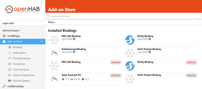

It seems to me that you have it running with OH 4 now - I’m not sure if that was the intention or not. You should be able to run it with 5.0 as a base, as you can see it’s there as “installed” in my 5.0 dev environment:
(Every binding is listed twice because of the JAR/Eclipse thing, only the JAR versions can be removed according to the UI, but of course they can’t really :wink: )

I now altered that. It of course threw some kind of error, so I started from scratch yet again. Now it seems to be working. I added the thing via a .things file, which was a first for me. Turns out I don’t have (an option) to chose which binding.
