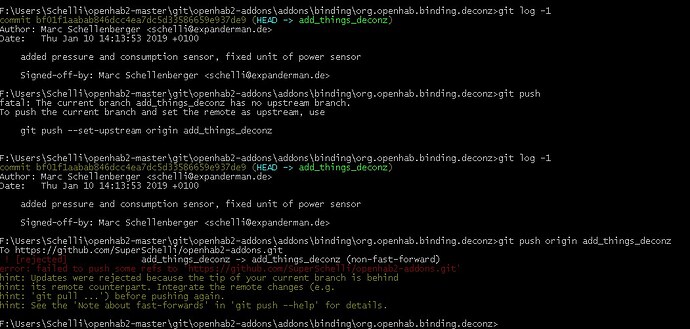

ok, regarding the push, i have done everything needed i hope :pray:
now i cant push again, i have provided a screenshot … just dont wanna mess up the next push :smiley_cat:
i have to make some kind of pull request first, but not entirely sure how to pull and push now
